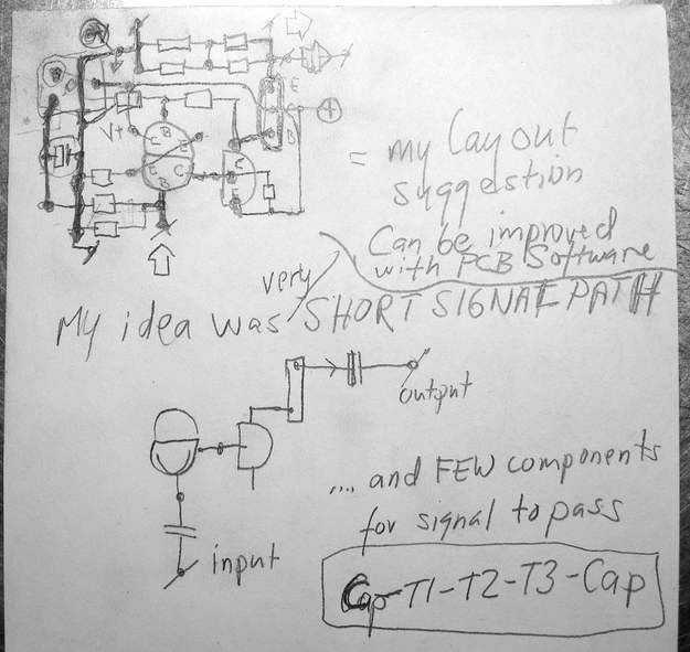

Here is my lineup original idea,
with Component layout of my circuit
( please respect my full copy right to this amplifier )

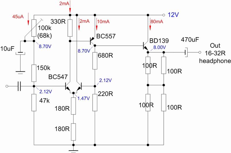

What could you say about the thermal drift which is essential for an A class amplifier?
I said that because the current through BC557 (and so on) seems too sensitive by temperature for my taste. Have you sense any change in sound over some time of continous functioning?
Despite Line up....this circuit is very interesting..i am very interested.
My resistance to construct it immediattely is because the power consumption.....as i will have to produce a supply, and this means that will not be portable anymore...attached to the mains...hummm...not good to MP3 player...as will need to be fixed.!
I am thinking to reduce voltage and current, to recalculate the whole thing to lower voltage transistors, and to use Nickel Cadmiun batteries, and i have a lot of them..all brand new..costed 1 dollar each one...950 miliamps each unit..AA sized.
The circuit may sound very good, as it is simple and class A...and with differential that we can try to make better that feedback line.

some more information
o.k. guys....
i have received a very nice mail from the guy that started this thread (thanks lineup for the kind words).....
i will quote him - it is the best.....
about my amplifier:
you see the load is 100 Ohm.
In fact the omtimal load for this type of class A is
resistors = headphone impedance
this will give maximum output power
and this means, setup is also the best QUALITY low distortion
performance
when load is = resistance in output stage
My output stage, is in fact compromise,
for amplifier to be good form 32 - 300 Ohm headphones
100 Ohm is in middle*!
formula:
if LOW = 32 and HIGH = 300 Ohm phones, you want to use
square root( LOW x HIGH ) = 97.79 Ohm
so, if you want to make special version for 32 Ohm
and lower voltage, it can be done
no problem
only some matematicals and some thinking
and some little changes
lineup
best regards and happy diy

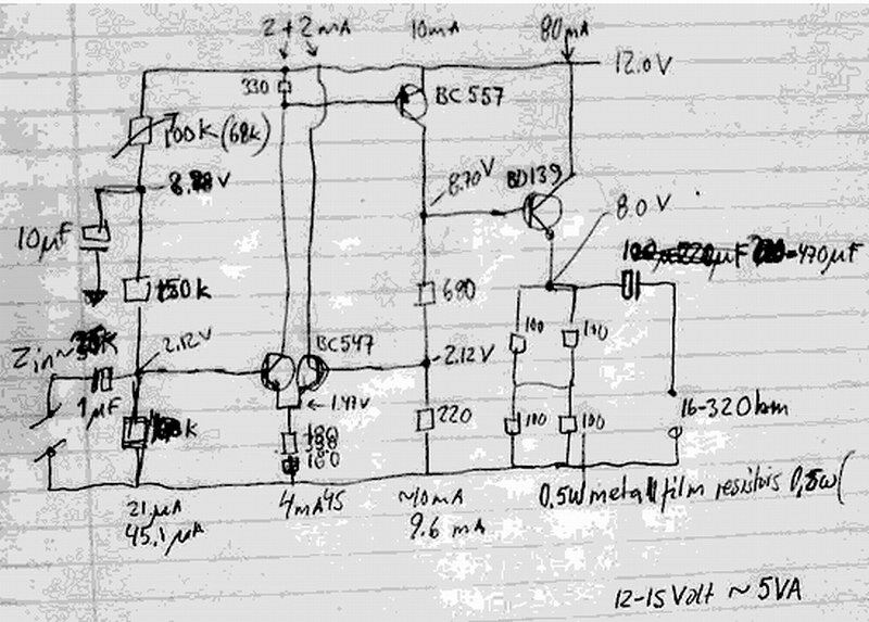

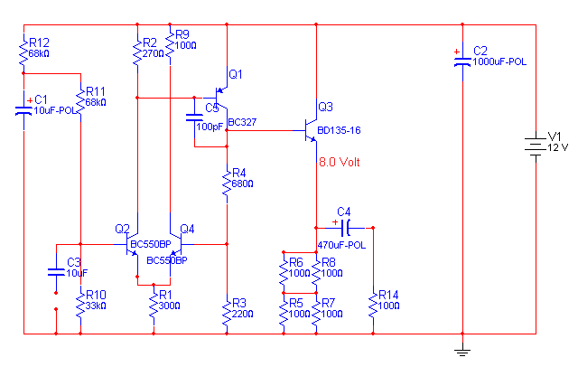

thanks sparkle
sparkle
thanks for your schematic clean-up
http://www.diyaudio.com/forums/attachment.php?s=&postid=999712&stamp=1157628903

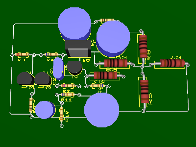

Just for fun
here is how an electronics program wants to arrange PCB layout.
I wouldnt build it like that.
I have shown a drawing in a previous post here,
my idea of a perfect placing of components onto a board.
Anyway
here is the computed suggestion
from a good but a bit stupid electronics program.
You know such programs, just like some people,
have very low ability to think out of the box 😛
Newbies and audio beginners, still have plenty of this quality.
As they are not yet inside the square and improved box of accepted audio ideas.
This is one reason, I like so much to exchange ideas with new diyAudio members.
Good for my creativity 😎
lineup

Hi Headphones amp guru here
this amp is truly good
is it supposed to be powered by mains supply?
there will be hum issues
also i feel o/p could have been more heavily biased
but it would make battery operation impracticable
for battery operation the circuit is very good
lineup has done a great job
cheers
john

Discrete Headphones ClassA amplifier - New version
Hello
thanks for your interest
this amplifier should be no problem to build
any contribution of PCB Layout Design .... fine thank you!
the original has got BOTH channels + one 12V regulator in one board
Designed to suit 90% of all commonly sold headphones.
Recommended Headphones Impedance: 32 - 300 ohm
Short general description:
100% Single Ended Class A operation.
One 3T discrete voltage amplifier, gain x4, with feedback,
with voltage output to a single NPN Voltage follower transistor ( buffer )
operating at 80 milliampere Class A current into resistive load.
Data:
Input impedance: 22 kohm
Output impedance: 100 ohm
Voltage Gain: 4.0 ( +12dB )
Voltage supply: 12.0 VDC, Regulated
Current supply: 95 mA per channel

POWER SUPPLY:
- <100 mA per channel.
- Transformer 12VAC, 5-10 VA
- Rectifier bridge 1.0A or 4 Silicon Diodes 1.0A.
- 7812 regulator TO220, 12 Volt 0.5-1.0A
New version, See Attachment Schematic,
components, changes, comments:
Q2-Q4 : TO92 : BC550C, BC547 or most any small TO92
Q1 : TO92 : BC327, BC328, BC640. 2N5401 will also work perfectly.
Q5 : TO126 : BD135, BD139. Also MJE340 will be fine.
R9, 100 Ohm, was only for measurement in my Spice Simulation.
To get 50-50% Current in Q2-Q4.
Not needed. Should be removed after eventual measuring.
C5, 100pF, was added.
Makes sure amp is stable and lowers distortion.
C3, 10uF. INPUT.
Should be film capacitor MKP Polypropylene or MKT Polyester. Like 2.2uF will be good.
For better square wave looks in my testings, an overkill high value was used.
C4, 470uF. OUTPUT.
Depending of your HeadPhones impedance this can be 100uF - 1.000uF.
470uF will do well with most headphones, 32 - 300 Ohm impedance.
A Good Quality electrolytic capacitor is more important,
than the actual value within 100uF - 1.000uF.
All resistors are metal film 0.25Watt.
4 resistors 100 Ohm, 0.25W in parallel/series is used
to make up one 1.0W METAL FILM resistor in output stage. ( 4x0.25=1.0W )
Because metal film resistors are the best quality resistance we can get.
Better than wire wound power resistors!
The amplifier voltage gain is defined by (R4+R3)/R3
900/220....... ~4.0 ( +12dB )
Unless you know what you are doing, R4 and R3 should not be changed.
Because this would upset the whole circuit.
Enjoy!
lineup
Lineup Audio Lab
http://lineup.awardspace.com/
Hello
Data:
Easy to find parts:
POWER SUPPLY:
C3, 10uF. INPUT.
C4, 470uF. OUTPUT.
Enjoy!
lineup
Lineup Audio Lab
