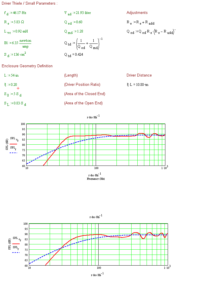

Here's the TL I came with for the Vifa P17WJ. I used MJK's worksheets and the specs for the Vifa P17WJ given by Zaph ( http://www.diyaudio.com/forums/showthread.php?s=&threadid=28673 ).
- The best simulations results were for a tapered TL with a ratio of 6:1, tuned at 40Hz. The length of the pipe is at 137cm and the driver is offset at 1/5 of the pipe. (see attached picture. At the bottom of the pic, the results for a "classical TL").

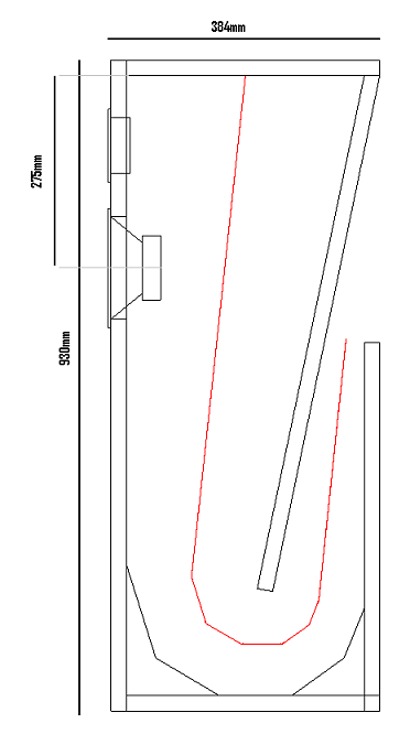

- The pipe is folded once and the port is at the back (inspiration comes from the FTA2000 of Bob Brines). Outside dimensions are : 930mm (H)- 244mm (W) - 384mm (D). 22mm mdf used.
- I still have to play with the location of the tweeter.

The design looks good, I like tapered TL enclosures. The only concern I have would be how you plan to handle the baffle step issue. The second set of calculations in the worksheets should help determine how the frequency response will look. Have you run those calculations and can you post the SPL response?

I am not sure, I don't know much about series crossovers, but it may be that the 6.8 ohm and 30 uF leg in parallel with the drivers and crossover provides the baffle step function. But the bottom line really is if it is already a designed and tested crossover for these drivers you should be all set.
