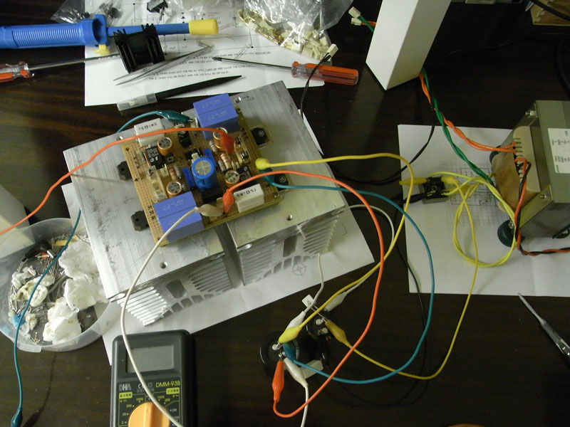

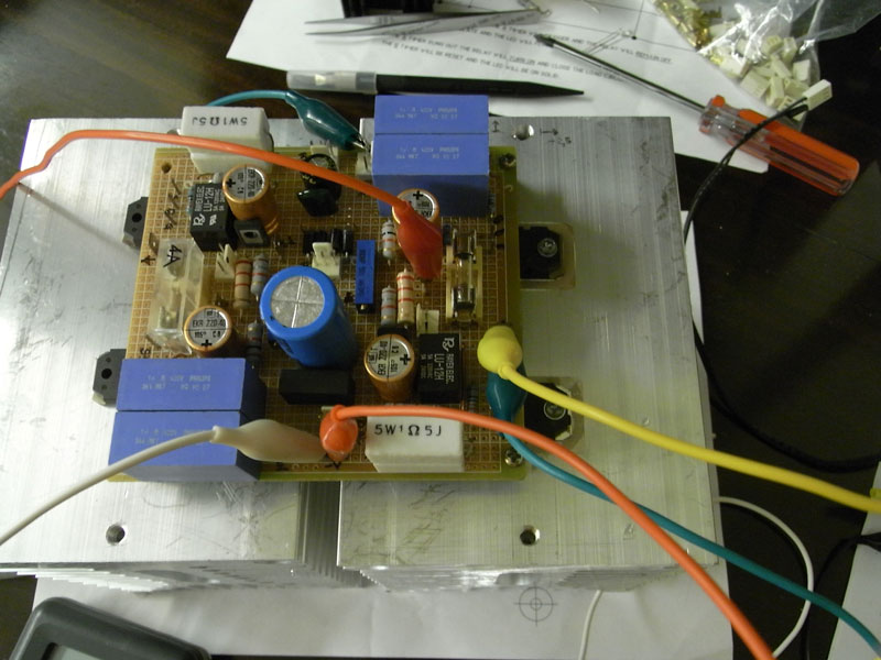

after 2 months, i came up with the PF in 2SK1058 version (which is not the one reccomanded by the author). I also add a tube VAS (in mu-stage) to provide acceptable volume level.
This amp is featured with a standby mode which limits the output current to 0.2A, while the normal operation mode the MOS will sucks slightly more than 2A.
Everything was fine while testing on standby mode: voltage at the source of the upper MOS was stable enough, while connecting to a headphone, i can hardly hear the hiss/hum. (tube was not connected to the amp board yet!)
However, while running on normal operation, the amp started to behave a little bit weird. Working point, current measured at the resistor were correct, but I heard a strong humming coming out from the headphone.
I just wonder why, does it have to with the crocodile clip wire because of the smaller gauge which could not sustain the high current? or may be because of the extremely hot resistor between the two PSU caps(~2A passing through 0.5ohm, ~2,4watt of power dissipation)? or bad earthing?
Any suggestion? thank you.
