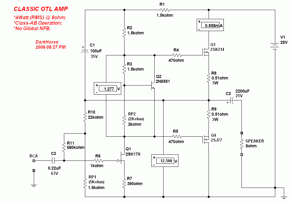

by adjusting RP2 to more small value,you can increase the biasing of output stage.make it up to 20mA~30mA is suitable.
one mistake I make,V1 should be DC32V if you want the circuit can ouput 4W(RMS),Using DC25V you can only get about 2.6W(RMS),sorry for this!

No global NFB?
There is a global NFB through R10 and R11. If You bypass RP1 by capacitor (for example), there will be no global NFB. Anyway, nice schematic😉
