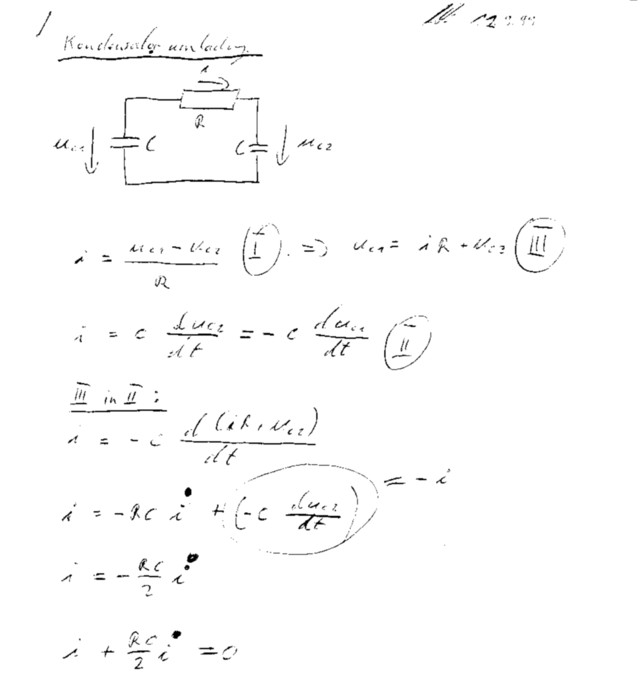

... just strolled through some of my old records and found a nice phenomenon, which might make fun to discuss here...
Imagine two caps.
Both have the capacitance.
One is charged (U1), the second is uncharged. The energy in the first is evidently E=1/2 x C x U1^2.
If we now connect ideal the second cap, then the charge will split half and half on both caps.... balancing at U2=1/2 x U1.
If we now calculate the energy, we will find that half of the energy is lost.. ... somehow.. each cap has just a quarter of the original energy.. Curious thing, only ideal and lossfree assumed components involved and still energy is lost.

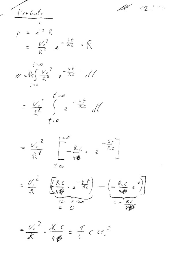

Some years back I started some calculation on this.
I started with an Resistor in between both caps and then planned to move the R mathematically to zero.... hoping to get reasonable results with the sentence of de l'hopital or similar...
Aehem well, of course before I could move R to zero.... I came to the well know result from capacitve switching devices , that the losses are independent from impedance of the switching device. As soon as you calculate the dissipated power the resistor drops out of the calculation....
Sorry for poor scan quality. In the last millenium my docu-system was not really high end 🙁

...so for me this charging-changing-event looks similar to a Dirac pulse.
Means: Indefinite high current pulse, indefinite short time, well defined energy.
E = t x P = t x I^2 x R = 0 x (indefinite)^2 x 0

rpapps:
Our trouble in the moment is that double C and half voltage DOES violate the law of conservation of energy. Half of the original energy is lost.
Which is also plausible, because if split two double C and half V the unchanged amount of charge is placed on lower potential. Less energy.
The funny thing that we are loosing the energy even with a theoretically lossfree charge changing model.
If you want to split the energy onto two caps without energy loss, you would need an addiotinal ideal choke and some ideal switches.
...resulting in a nice energy transfer and then the voltage in each cap would be something like 70% of the original volatge.
This resonant event would nicely match to the law of conservation of energy, but would somehow violate the law keeping the amount of charge constant.... charge is then more afterwards, but we did not supply external charge... strange world !
Our discussion is based on the following phenomenon:
Imagine two caps, both 1F.
In the beginning Cap1 is charged to U1=2V.
Cap2 is uncharged:
Total energy in the beginning E1+E2 = 1/2 x 1F x (2V)^2 + 0 = 2J
After connecting the second in parallel, both caps are charge to half of the voltage:
Total energy in the end: E1+E2 = 1/2 x 1F x (1V)^2 + 1/2 x 1F x (1V)^2 = 1 J

SY said:Here's an analogy that (at least for me) clarifies things. Imagine your first situation, a cap with a voltage V and a charge Q. Now, move one of the plates closer to the other to increase the capacitance...
Hi SY,
I think in your example things are less strange.
Due to opposite charge on both plates there is mechanic force, which is pulling together both plates.
If we now make one plate movable (and free of friction), we could use this force to pull something up. Mechanical energy can be calculated by increased mechanical potential energy or by integral of F (ds).
