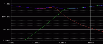

I would submit that the simulated (or actual) voltage seen by the drivers under passive EQ is the target voltage response for the active circuit. However, it may be better to use a graph of the audible frequency response of the actual unit rather than the raw voltage--any opinions?

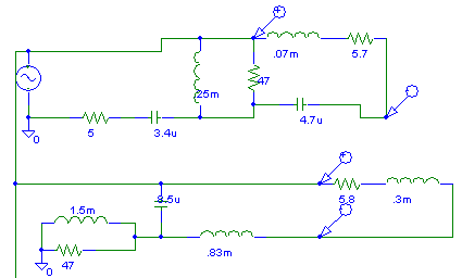

A good starting point for simulation is probably the following schematic:

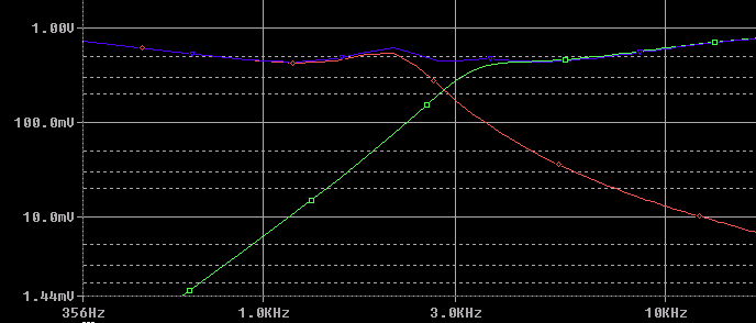

The response is shown here:
The tweeter has a firm 18dB/octave response. The woofer starts at a 18dB slope but tapers off a bit towards the higher frequencies.
(the audible tweeter response will be higher due to higher sensitivity, but the xover point and slope are unchanged)

(the schematic below is just to provide some point of reference for where I am going with this--no need to read anything into it!)

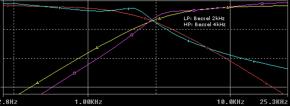

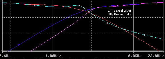

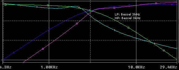

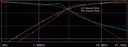

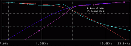

No responses yet, so I've started playing with some filters. The first set will be Bessel-alignment 3rd-order xovers. There is a real compromise between matching the electrical (voltage) slopes of the proac drivers and the summed response, as you will see. I think there is still a question of whether the slopes even should be matched, or whether a crossover frequency should simply be chosen.
On to the pics! It should be pretty obvious which are the driver responses in each set and which are the filters.
Best matching: LP at 2kHz, HP at 4kHz.

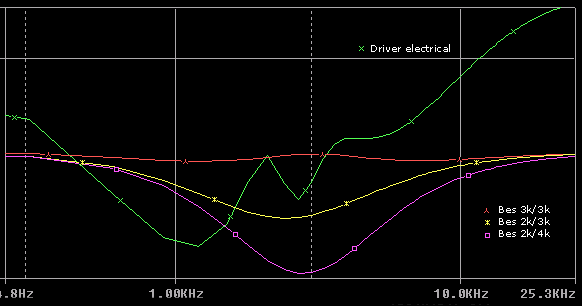

Now for the summed responses. It is pretty clear that the closest match is probably unacceptable. While the 3kHz/3kHz filter is certainly the flattest, it may not sound as good as the 2kHz/3kHz that more closely matches the original Proac response.
Any thoughts from the gallery? I will be experimenting with a Butterworth alignment next, which will probably even out the trough in the less "correct" filters (e.g. 2kHz/3kHz), if at the expense of some other things.

I've just read through your posts. I have also simulated the passive xo response with Electronic Workbench and got the same hump at 2Khz. I think it is partially due to the .83mH in the LP filter. If you remove this inductor the response will flatten.
The other reason for the hump is the raising response of the 18W8535 driver starting from about 1,5 Khz.
The corner points of the filters approx. are 1,5Khz (LP) and 3,8Khz (HP) anyway.
Zoltan
