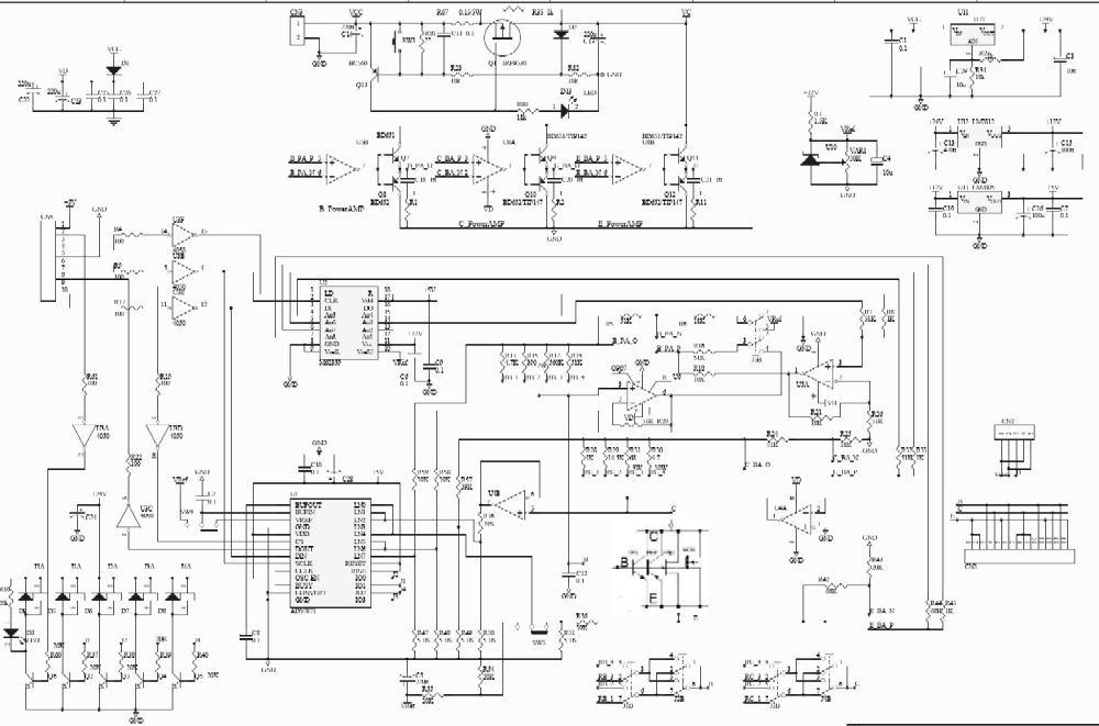

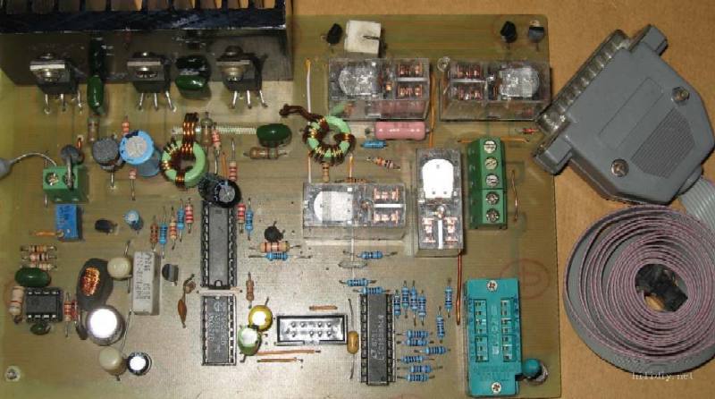

The project use 5 integrate circuit, They's:
1 chip LTC1090(8 channel 10Bit ADC with SPI interface)
1 chip M62359 (8 channel 8 Bit DAC with SPI interface)
3 chips TDA2030 as 3 channels(B C E) programme Push-Pull Power Supply
1 chip 74HC595 as control relay
1 chip TC4050 with PC interface buffer
the instrument don't use MCU,just use PC's parallel port (LPT) to controle the DAC & ADC

the result is here
http://www.hifidiy.net/bbs/dispbbs.asp?boardID=2&ID=31462&page=1
the sch public here
http://www.hifidiy.net/bbs/boke.asp?locky_z.showtopic.92.html
but software is shareware.
I have a little LTC1090 & M62359 chips, just only enought to develope and use for me.
So the board is not sell.
the sch public here

The schematic had changed a little,see below.
the software can download from
http://bbs.hifidiy.net/attachment.php?aid=246124
http://bbs.hifidiy.net/attachment.php?aid=246125
It is Chinese language version , only support one curve trace.
the board no MCU so it not support USB interface,only support LPT interface
