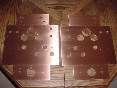

Well, after a month of working and clear coating copper plate I have learned a valuable lesson. Boy, oh boy! sure looks great but aluminium is a lot easier to work. Anyway the wood bases are next. Then I hope all you wonderful folks at diyAudio will help me with all the questions about hooking all the wires together. I attached a pic of the plates because, I need a slap on the back. (back of the head is more like it and feel free)😀

I for one have to applaud your workmanship on your plates and your amp. Copper is hard to work with but it does show your love and enthusiasm for your project. You could have taken the easy way out and saved time with the T6 6061 Aluminum alloy but you choose the better and your project proves this. There are no free rides and no free lunches. Why settle for fast food take out when with a little more effort a gourmet feast is at hand?
If an award was given based on craftsmanship you would have my vote as your project is stunning.

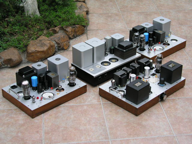

Here is a pic of the finished monoblocks and a matching preamp, speaker project is next.
hi maybeim,
pls trust me that I post this photos & my site is not mainly to earn money.
They were not the kits, they were me & my friends amp.
see more photos for my another friends transformer couple 300b amps.

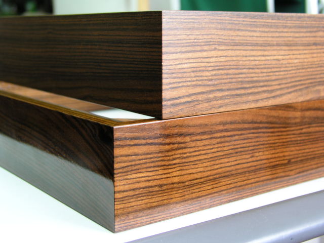

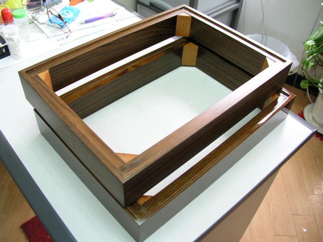

hello maybeim ,
this is recently I made.
I use vintage eastern wood craft with piano finish to make the wood chassis already.
Do U feel good. Pls give me some advise.
I hope I use diyer's heart to make diy goods will fit to all diyer.

Hello Thomas,
First, the wood bases look, well, like wood bases. I believe that the joinery (corners) is run of the mill 45 degree butted joints, which are the easiest joints to make and the least for structural strength. If you were to use dovetail joints or some other joinery the aesthetics (looks) would be greatly improved.
Choice of woods is not as important as the choice of the figure (grain) of the wood. The wood needs to be beautiful on it's own, before sanding and finishing. I do not care for straight grains and look more for a quilt and mottled look. Burl figured wood is the most beautiful and the most expensive wood one can buy. Finding burl large enough to produce a chassis is next to impossible and very, very expensive.
Aluminium plate is cheap and easy to work, very forgiving on finishing. Copper is the champagne of metals when it comes to making amp chassis and it shows. Very beautiful when the chassis come together.
All in all, you get what you pay for and planning and effort shows in ones work. I think more like an artist than an engineer, because I am not an engineer.
You do have a commercial website and are selling components to the diy community, even offering a service for custom-built chassis, I believe.
I wish you luck in you business adventure and there is room for improvement in your artistic tastes for chassis building, which also goes for me, as everyone learns as we go through life.
hi maybeim,
thanks for your complient.
actually I use the tail with all the join already to increase the strength.
The wood I choose was hard wood 1 inch thick & raw the 4 mm depth for the plate.
I still thinking the copper plate. Can u told me that how much cost for the surface craft for the copper plate??
Is it really very expensive??
The best now I can find in hong kong was the USA made 6061 or 7075 aluminium alloy. The company told me that was 6061 use in 747plane & 7075 was the f117 plane use.
I don't know the journey that i walk was right or not. I only want to prepare a reasonable chassis but good strength & good look for the diyer.
Good & cheap is my wills.

Copper costs more than aluminium. If you can use a plate thickness that is thinner than the aluminium you now use, the cost will go down. The problem with thinner plate is structural in nature, it could buckle if it is to thin, when you load it with heavy transfomers. It could be possible to add braces to add strength or go with thicker plate.
I sprayed a polyurethane ( plastic ) coating over the finished plates. Just the tops that show, not the bottoms that no one sees. Since the amps will never be outdoors, the finish I used is fine for indoor use.
DO NOT BUY COPPER WITH BERILIYUM, very toxic.
