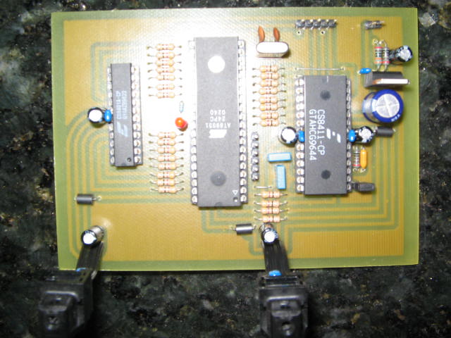

Ulas said:Exactly how are you going to determine how many duplicate or dropped samples you will be hearing or not hearing?
Take a look at my spdif interface. The DIR is CS8411, controlled by 8051 mcu. I can monitor the slip flag and reset it each time its set.
The oscillator will obviously reside in the converter pcb.
Alexandre
