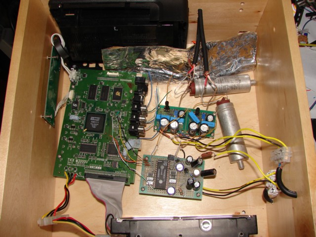

Here is my 160GB server base on the TVIX module with TD1541 and I2S tapped from the TVIX board.
Output stage is a variation of Mr Pass D1 (jfet circuit thanks to stefanobilliani)
And the sound is the best I had so far. It was a big jump in quality when dropping the cs8414 and go I2S direct.
Here's a pic. Everything in a wooden box.

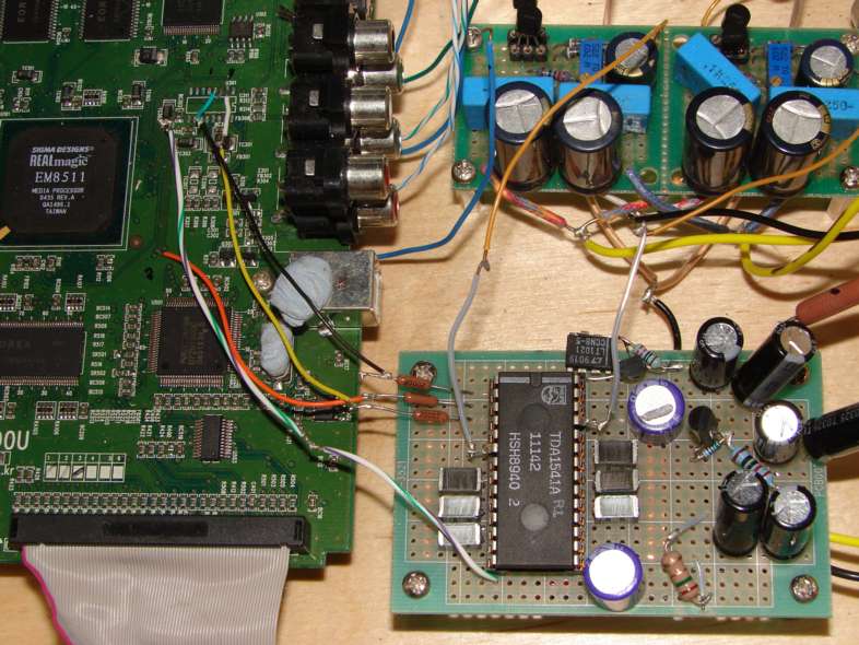

Close up of the I2S connection.
The original CS4340 dac was pull and I2S signal tap from those pads.
The TD1541 uses LT1021 for +5V and TL431 for -5V and a larger discrete power stage for the -15V (not shown here)
OsCon, ZL and stack film type for various decoupling.
The I2S is output from the dsp chip EM8511.

The under side of the point-to-point 1541 dac.
Ugly, but it works. A small copper foil ground is use directly under the dac. All decoupling is to the analog ground.
A large tant cap is used for the LT1021 as suggested by the datasheet.
Hopeful, my next tweak to this dac will be the DEM reclock but not enough time.:)

This is the TVIX media player before I took it apart.
http://www.tvix.co.kr/Eng/Products/M3000U.aspx
But it does sound so much better in its current mutilated form.
I use EAC to rip all my CD in wav format to my 160G hd. This media player needs to connect to the TV for the display and selection of songs.
In its original form, the TVIX mades are very good transport, quite a bit better than the Philips 963 dvd I once had. But the true potential is in using its I2S. It made you wonder why SPIF was invented in the first place.

There is a small board attach to the side next to the large ferrite toroid, that is the infra-red with 3 led for status. I drill holes in the front panel for the infra-red and leds.
I use component cable to connect to the TV, not yet connected in my first pic, but you can see all the rca sockets next to the TVIX board.
