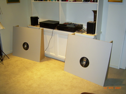

Hi Colin,
I too have a pair of the Peak 8CX50's and I'm building them a pair of Coral 8CX501 BR cabinets. Do you mind if I ask what you've done with yours?
Doug
PS I quickly knocked together a pair of OB's for them. Fantastic!

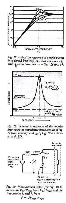

Hi GM.
I'm not saying you are wrong, in facct just the reverse.
I'm measuring an 8CX unit using the system outlined in Rod Elliotts web page, which I have used successfully before, but am getting answers I don't trust.
Specifically
Qms 3.17
Qes 1.67
Qts 1.09
Vas 55.2 L
I have two possible problem areas.
The original cloth surround had gone hard, stiff and brittle so has been replaced with rubber. This has lowered the res.freq to 38 Hz. from your 40. The spider seems OK.
The sig gen is an old philips which I have just resurrected and may be off.
You commented your results were from reverse engineering, which I took to mean not from measuring an actual unit, so I was just looking to see if anyone had . Regards
Ross

Greets!
Bummer, I was hoping you had more accurate ones that indicated a lower Qts since I fudged them on the high side to calc a too large a cab since it's easier to shrink one than stretch it.
Anyway, you're right, mine are a complete SWAG based on similar Corals and the two BRs designed for the 501, so could be pretty far off, though they would have to be in complementary ways to perform well in it. Note too that a Qts this high wouldn't have been put in a BR and the calc'd eff. is way low compared to the published specs, so something's amiss.
GM
