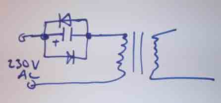

I have this 800 VA 220 primary, 47-0-47 secondary toroidal transformer. It gives 65-0-65V after the bridge. As I only need 50V can I unwind some coils? It also buzzes a bit, even when at no load. Is there anything I can do to fix this?

Yes, you should be able to remove some windings to lower the voltage. Be sure to remove an equal number of winding from each side to maintain the same plus and minus output voltage.
Humming is generally due to mechanical resonances and can be difficult to eliminate. Be sure to fasten it down snugly to the chassis. Another coat of varnish might help, too. Hopefully others can some some other suggestions.
miguel2 said:I have this 800 VA 220 primary, 47-0-47 secondary toroidal transformer. It gives 65-0-65V after the bridge. As I only need 50V can I unwind some coils? It also buzzes a bit, even when at no load. Is there anything I can do to fix this?
You could also wind a "counter winding" with the opposite sign. Normally you have 0,3 V / turn.
The buzz may come from DC on your mains. Maybe you need a DC-trap? Fat Cap with two diodes in parallel across the cap.
I'll try to unwind it a bit and put some extra rubber underneath it to see what happens. Thanks.

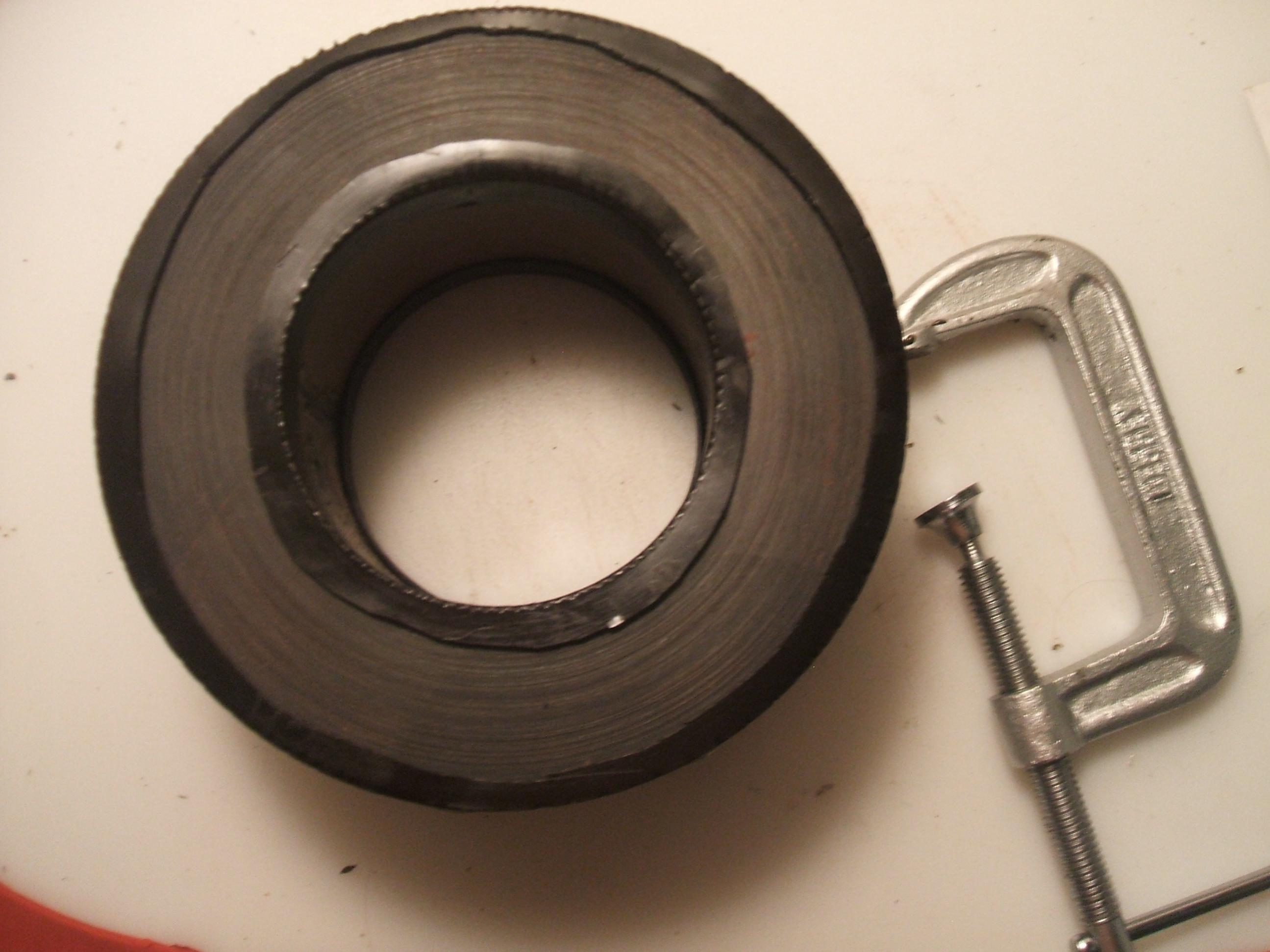

This weekend I made this unwind and could lower the voltage around 10%, which is quite acceptable. But now it makes a lot of noise, I believe from mechanical vibration. I was carefull in puting back all the tape, but it really was already making noise before. Any suggestions? 😕
