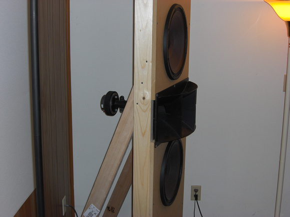

Open baffle speakers -
Dual 21" Woofers 45-330 cycles 99 db sensitive
Dual JBL 2123J 330-1400 cycles 105 db sensitive
Heil Air Motion Transformer 1400 up - broad band notch filter 96 db sensitive
Horn loaded subwoofer 50 cycles down
Quad Amped - No eq needed with high sensitivity/QTS bass drivers
Sound is HUGE and natural with excellent bass definition and impact. Dynamics are very good.
[/IMG]

How would you rate their performance compared to your various horn setups?
It is very good - lacks the ultimate in dynamics you get with a good 5 way horn systems but still amazing. It is very coherent - I used my Acoustat Spectra 3 fullrange electrostats as one reference when building these. These whipe them up.
Here is a comment from a freind that has heard many of my horn systems:
"i think your current setup ranks up there among your best. that dipole bass was super clean and seemlessly integrated with your subs. i would have to say that i have never heard anything as good."
Others have said pretty much the same

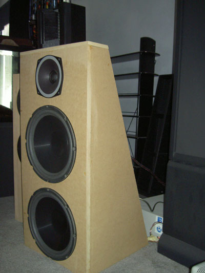

JohnL said:What are you using for crossovers? Active or passive?
BTW, this is where I'm at now. It's a junior version of yours.
Those probably sound great - what drivers are they?
I use active Marchand XM1 modules with Teflon caps and OPA2123's - it's pretty darn transparent

Magnetar said:Those probably sound great - what drivers are they?
The drivers are PHL 1120s and B&G IB12 subs. B&G was getting out of the IB sub business and blew out those subs for a song. Hardly the last word in SOA bass driver, but the specs and price was right to get my feet wet with OB bass.
They do sound good, the AMT/PHL combo is probably the best I've ever heard in that range. The bass sounds good, actually great, but I think it could be better with better drivers. Perhaps I should look at those Madisons, do they really sound OK up to 330 hz? I have a set of Hartley's here, maybe I'll pull the 24s out of them. 😀

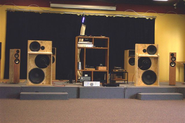

Here is what a freind said about a recent gathering at my place --
" Hats off to Magnetar for another great "Ears and Beers"
his system is simply jaw dropping, I had so many big grins during dynamic music that my cheeks hurt. From the obscure to Classical it was all great music, good food, drink and laughs........hats off Mike!"

The low bass is horn loaded -
Are these better than a good horn? Maybe in a couple of ways but surely not in all. It is a compromise as with all speakers. The main compromises with dipoles have already been addressed in my previous posts you linked to ..
If you knew me you would understand I have built many different types of 'low-compromise' systems - I built the original linkwitz system when he put it in Speaker Builder years ago except I used much better bass drivers- it was OK - nothing like this. Like many other sytems I have gotten tired of I image this will end up becoming just another pile of wood to burn in the fire pit.
I was looking to do something different - as you can see I used a completely different system then the linkwitz baffles most people copy plus I use no eq and high pass the bass drivers. Because of the size of the drivers and the horn loaded low bass it would take more than ten good 12" drivers to 'keep up' in the midbass with these - and maybe 20 12" dipoles to keep up in the low bass
I did this knowing
1) I didn't want to boost the naturul response of the bass driver like linkwitz does and use more power to compensate for using the wrong drivers to begin with.
2) I wanted much higher SPL capability then something like the orion.
3) I wanted less dynamic compression then something like the orion.
4) I wanted the bass drivers to operate to 300 cycles with little compromise.
5) I didn't want to follow in someones 'footsteps'
6) I wanted to try a system that has dipole radiation from the bass all the way out to the highest treble using high efficiency dynamic drivers.
7) I wanted to use a WMTMW format to load the room differently than the orion. I have had the big Dunlavy speakers and they were OK in my room in the bass but very compressed and anemic sounding - I wanted better.
8) I wanted a system that was as cohesive as my full range Acoustats with REAL DYNAMICS and bottom end power and a wider listening window and freindlier load. It's difficult to do this (cohesive) with horns and still have a wide listening area - mother nature is at odds with widely space horns -
