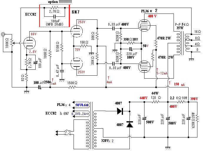

So, today I desing and built :
PL36 PP Amplifier 22W class A , with 6N7 and ECC82
The PL36 pentode was originally intended for use as a line output, (or horizontal deflection) valve in television receivers.
Full construction details and my experience with PL36 PP Amplifier can be posted here, or sent to email if you need that.

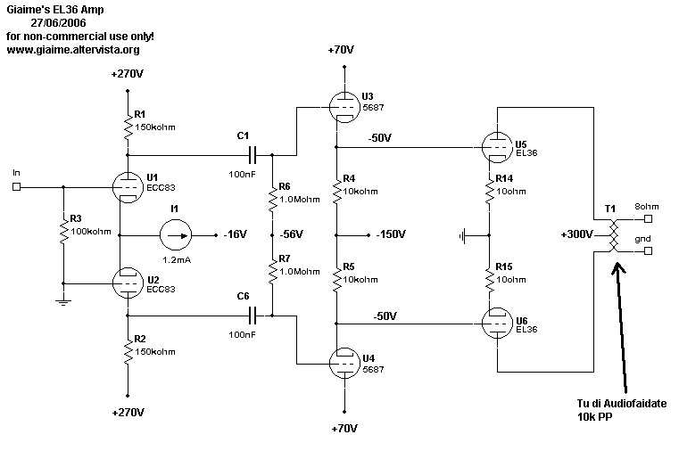

I'm also working on a EL36PP, but in triode mode, should give 10W in class A.
Tell us more about your design!

I start with 450V and all work perfect!!!!!!!!!!!!!!
Now 400V.
I have 3 diferent Philips Tungsram and Telam Four matched tubes.
Tungsram is the best.
PL36 is beter then 6L6 and similar with EL34 !!!!!!!
this is maximum from PL36 .
The prototype amplifier has been running almost non stop since It was built. more then 10 hours .
regards
mario2005

Hi Mario2005,
neat design, but what is the objective of PL36 in (horribly non-linear) pentode mode, when you can get the same power from extremely linear triode strapped PL36 PP?
See this link.
SY: Yes, PL36 is used even more grossly over specs in this design. But they will stand it. I suspect spec sheet design center ratings were really given with TV deflection duty in mind.
Tom
See this link.
Tom
Tubes4e4 said:SY: Yes, PL36 is used even more grossly over specs in this design. But they will stand it.
You beat me to it.
The E/PL36 is an extremely tough tube. It'll take 22W before plate glow
I have no idea why it wan't used in RF service 😕
mario2005 said:triode mode PL36 PP and 380V
If the driver/splitter will work as required (I didn´t check this), you will get about 20W Po in class AB1 using this output stage setup, delivering about 8W in pure class A which should be more than enough for sweet listening.
Damping factor will be about 3,5 w/o any gNFB applied, which is decent already. Nevertheless I would suggest to use about 6dB of gNFB, but nothing more than that is needed. Certainly not the 20dB you mention in the circuit diagram, which probably is just a left-over from the previous plain pentode (errr ... beam power) version.
For EL36/PL36 triode strapped plate curves have a look here, although this plot will not cover the actual Pd you are running your PL36s at. But you can easily prolong the curves 😉
Tom

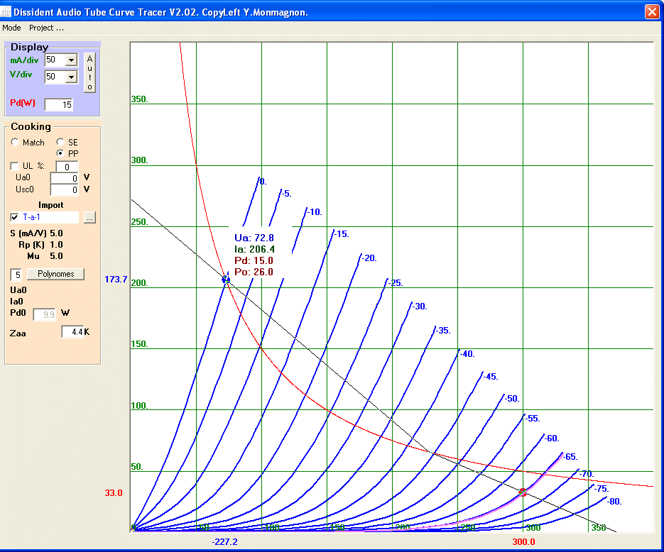

Hey, look at my new toy 😉
Trioded EL36 AB1 PP simulated with 300V into a 4K4 Zaa, and "cold" biased at 33mA, that is 10W at idle.
Well, I go a bit over the 15W line ... but no more than half the time.
Should deliver roughly 25W, but needs a lot of drive 😡
Yves.
