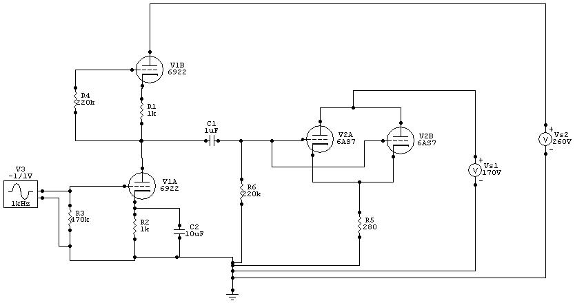

Now I decided to use the components to try an OTL for 8 Ohm speakers, improving the project.
First of all I tryed this schematic:
http://utenti.lycos.it/pcclubfermo/OTLb.jpg
As you see I left the driver(e88cc) as it was and I added a 6080 in output stage. I know that this configuration give about 1W, but it is enough for me. My idea is to add one more 6080 in output stage, but first of all I wanted to know how the ampli sound.
The problem is that the sound(with 98db loudspeakers - 8 ohm) seems to be little distorted and with poor high freq.
Where I got wrong?
3 x 6080 need improved driver?
Or Cathode need lower res. value than 160 ohm(for example 120 ohm)?
I know 3 x 6080 in this configuration has an output of about 20 ohm, but many people say that it's enough to drive 8 ohm speakers.
Help needed! Thanks!

In order to produce significant output you need to ensure that the current through the tubes and the cathode resistor is much higher. 1A standing current will give you a theoretical max output power of 4W as the peak output current can never exceed 1A and output power is Ipk^2/2*Rl. 2A will give you 4 times as much output power or 16W, the real output power will be lower as it is impossible to use all current swing.
A problem will be power dissipation as the circuit will dissipate 170V * the standíng current so you will dissipate 170W to get 4W output power.
It seems that with 40V over the cathode resistor and 170V B+ a 6080 will draw 160mA which will be 1A for 6 sections in Parallell, 160mA is a bit higher than allowed but should probably be OK, anode dissipation will be ~21 per section which is too high but it will work at least for a while. The cathode resistor should be 40Ohm and will dissipate 40W continous.
I don't recommend to build an amplifier like this but the example above illustrate the problems with building a class A OTL and this is the reason why all OTLs on the market are working in class AB except for the low power SET OTL offered by Trancendant which gives 1.5W
Regards Hans

Using 80 ohms will give you lower output power as the current will be lower, to find the current with any resistance you need to look at tube curves like these http://www.triodeel.com/6080_p4.gif and find the point where the grid voltage is R/I where R is the cathode resistance and where I is the current you want to have for all tubes in parallell. (Example -40V grid voltage gives a current of approx 160mA for a anode voltage of 130V so the resistor should be 40/(6*.16) = 40ohm).
To drive cathode followers like this is easy as the input capacitance is very low but you need to provide enough voltage, I would imagine that a 4W version will need something like 80V Pk-Pk which should be possible from the ECC88 (which BTW is coupled like a mu follower and not as a SRPP)
Regards Hans

When I wrote lower power with 80ohm I compared with my original recommendation of 40ohm, 80 ohm will give lower current and therefore lower max output power than with 40 ohm.
The loss of high frequencies is probably due to the cap of 500pF to ground in the mu follower, I don't understand what it is doing there, it seems to a deliberate attempt to limit high frequencies, remove this cap. (I didn't notice this cap from the beginning)
If you have the possibility please measure with an oscilloscope on the grid of 6080 to see if the mu follower give enough voltage and expected wide frequency response.
BTW, I encourage the idea to test a simple OTL circuit, when you discover the superiour sound of this compared to practically anything else I believe you probably want to build something more practical like this http://www.tubetvr.com/otl.html
Regards Hans

Remember the 6080's max dissipation of 13watts, so dont go over 100mA per triode section with this psu voltage. Although these tubes are super tough, I've run them much harder, by accident, and they are still running fine.
I agree with Hans in regards to how awesome OTL amps are. Something must be wrong since I've never had high frequency problems with OTLs.
Since the sound is slightly distorted, perhaps the tubes are faulty? Try another E88CC. Or maybe a resistor is the wrong value? Is the problem in both channels?
I know this circuit works ok, it doesnt take much to alter the circuit you now have to this, try it...
You really need an oscilloscope of some sort, audiotester is a great tool using your soundcard, it cost a little but well worth it. Just remember the soundcard has low input impedance,(will load any circuit you measure), and doesnt handle high voltages. A tube buffer is a good project too...
Another thing about these power triodes, 6080 and 6AS7, is they have poor matching. One triode will perhaps have 30mA thru it and the other 60mA with same bias and voltages. So you really should have cathode resistors on each leg. I use a whopping 10ohm resistance, and even without any loop feedback the amp has full control. (My speakers have two 8" bass drivers in series, so the amp sees 16ohms in the bass, which may explain this.)

P.S. I saw your schematic. I think cathode R 280 Ohm may be high. 200 Ohm give more current. 😉

Ok, 3/4 of the problem solved.
It seems that the amply doesn't like filaments of E88CC and 6080s connected in the same windings.
Since I have another transfo 6.3V I just separated them and now ampli sound much better(it gained many high freq, and lost some roughy) but still not lively enough.
I realized only a channel(only to try the schematic and it's sound) so mu follower is in a single tube. I know that it's not a good idea(like for the SRPP).
Maybe in a stereo version, with the high sections of mu follower in a tube and the lowers in another tube, the sound will improve.
Glad to hear it is almost fixed. I always bias the heater voltage at some positive voltage since sometimes I get strange noises when not. Connecting one side of the heater voltage to the 6080's cathode will give a perfect bias of about 50volts. This should eliminate any problems from the heater.
The E88CC shares the voltage between them, so they are fine with this voltage. Note that the circuit I posted the E88CCs are not SRPP but so called 'aikido', which I think sounds best of the two.
The 280 ohm resistor is if only using two triodes, since you use 6, the value could be 70 ohms.
Oh, you asked in the first post how to calculate anode dissipation. The voltage over the tube multiplied with the current equals dissipation. So if you have 48 volts at the cathodes, the voltage over the tube is 170-48=122V. Next assume each triode shares the total current equally, they dont but itll be close enuff. If using 100ohm resistor you have 480mA total current, divide by 6 triodes and thats 80mA per triode. Dissipation is 122V*80mA=9.8watts per triode.
Ok, thank you very much.
Now I am studying improvments. The sound is good but not exceptional.
I think to do this:
1)bypass the big output cap(3000 uF) with a paper-oil 2uF or more(it's a good idea or not?)
2)increase the gain of e88CC mu-follower(but I can't find good formulas in the web for mu-followers, so I don't know how to do without destrying E88CC)
3)add 1 more 6080 and decrease the value of cathode res proportionally.
4)try a tube rectifier supply for 6080. I like very much the improvment in sound that tube rectifiers give.
I think to use something like this:
EL3C
Tantalum Anodes and xenon gas filled full wave tube rectifier.
2.5A max... 😀

I made some experiments.
I saw that the line stage of "triodino" 6SN7 uses the same values in the mu-follower as my otl schematic but the V+(which is 335V instead of my 260V with E88CC)
triodino
Assuming that 6CG7 is similar to 6SN7 (and pin to pin compatible with E88CC) I just had to upper the V+ to 300V and tryed this tube in my OTL.
I noticed I had lower gain but much better sound(more "crystal" and dynamic speed, and also more "complex")
Someone know why 6CG7 sound better than E88CC in this situation?
And it's "electrically correct" this experiment with 6CG7?
Finally, what I have to change in the mu-follower if I want to try a high gain tube like 6SL7?
triodino
