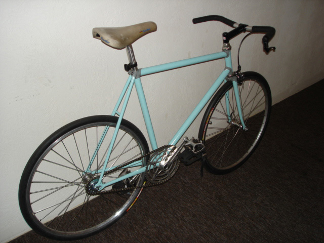

Since your bike is from '92, I suspect a no-go on the fixed gear conversion due to it likely sporting vertical droupouts. Fixed gears are a hoot. I own three DIY fixed gear frames myself. But, I would not describe them as "relaxed" bikes to ride.
Max

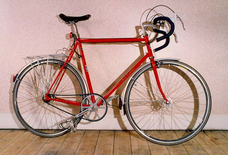

Thaks for all the advice, chaps. I'm concerned about bending the hanger back because since being bent by the crash, the derailleur has twice been caught by the back wheel and the hanger bent even more severely each time. Naturally, the derailleur shouldn't have been caught by the back wheel, but the indexing on the gears was working properly, so I don't see that it could have been far out of alignment. The jockey wheels are quite worn, and I'm wondering if that might have contributed to the problem as occasionally the chain would ride up and rub against the derailleur cage and need a slight backpedal to clear it. That's what happened the instant before the final derailleur/rear wheel disaster. I had wondered just what chain/sprocket wear was like with the 10-speed setup and thought it might not be good. Perhaps I will have to try a 10-speed derailleur on the existing set-up.
maxro: Don't get me onto single-speed bikes! I also have a single speed bike with nice Campag track hubs (hardly any dish) and track dropouts. I broke a TA crank last year (that's why I've been riding the geared bike round town). Can I get a replacement TA Cyclotourist 177.5mm crank? Only if I order a pair from Canada (expensive). And rings are no longer readily available. I've just ordered a shorter Campag bottom bracket that I calculate should allow me to steal the chainset from the geared bike, put it on the single-speed bike, and get a decent chain line. All I then have to do is to modify the chainset and fixings to only take one ring. Shouldn't be too hard with the assistance of my lathe.
Both bikes are 653 steel, but that's because that was all that was available at the time (and it could be custom-made to fit me). What are other frame materials like?
Edit: The 102mm Campagnolo Record bottom bracket has just arrived. Is it gorgeous, or what? I think we have a result. The 102mm BB puts the cranks (measured at the pedals) approx 111mm apart, whereas the old 111mm BB puts them 120mm apart. That means the chain ring will move inwards by 4.5mm, which is just what I need. But I need a special tool to fit the BB, and I'll bet it doesn't arrive in time for the weekend. :bawling:

Yes, the 54/16 gearing isn't good for hills, but it's great for skedaddling short distances on the nearly flat and is OK for a reasonably short 10% gradient.

Ec8010, I wasn't suggesting the fixed gear, that was rdf.
And, you can probably straighten out that hanger without a respray. I have done dozens of them. Start off with a 12" adjustable wrench to get it roughly in line, then switch to the park DAG-1 or similar, to get it spot-on. Or take it by a GOOD shop to get it done (It is amazing how many hack mechanics there are out there).
rdf, yes, the relaxednes is in the frame geometry:
The first frame I built around 700x35 tires with fender clearance. All old standard diameter lugged Columbus Brain tubing. It has a long wheelbase and I raked the forks with a tight radius at the tips. It has 55mm of rake with a 70deg headtube IIRC. How's that for relaxed? It was originally a freewheeling single speed, but has since been fixed.
The second one was an experiment in lateral triangulation, fillet brazed, with double 1/2"seat and 5/8"down tubes. Built for track use, it has a short wheelbase. I goofed when I built it, as I made the seat tube the same length as I would take on a road bike, forgetting to account for the higher bottom bracket. This resulted in zero standover clearance. Also the 7/8" round fork blades flex a lot with a front brake, so I don't use it on the road. The doubled tube experiment made for an interesting ride. It sort of "winds-up" under pedalling load. In a good way.
My third fixed frame (pictured earlier) was also built for the track, around 650c wheels and lugged, oversize Columbus tubing with a sub 36" wheelbase. I have re-commissioned this one for road use with 26x1.25 wheels and a more upright bar. Man, those little wheels lose all their momentum over rough pavement. There's something to be said for larger diameter wheels.
