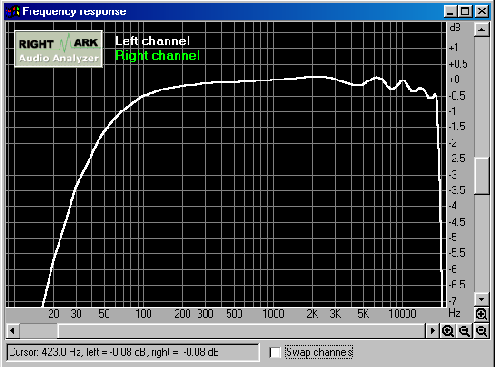

Oh, one thing. When using that frequency generator-don't forget your sound card has a frequency response, too. When I checked the response of my sound card-which I had trouble installing-I found that I had some midrange sound and nothing else.
I reinstaled my sound card and got decent response, but still. I am 3 dB down at 33 Hz and 6 dB down at 20 Hz-something to consider when running tests on a speaker, especially one with good bass response.
When doing the impedance check at the link I gave above, be sure to test both the voltage acrosss the resistor ad across the loudspeaker.
Oh, one more things-to make the math easy, use a 1 ohm resistor for the test.
Here is the response of my sound card, even after I re-installed the driver.
The following response is from the Right Mark Audio Analyzer, a freeware downloadable program to test your sound card available at:
http://audio.rightmark.org/
All it requires is a 1/8" stereo plug to 1/8" stereo plug connector to be put between the Line In and Line Out of your sound card. In the USA, Radio Shack sells them for three bucks, # 42-2497.
