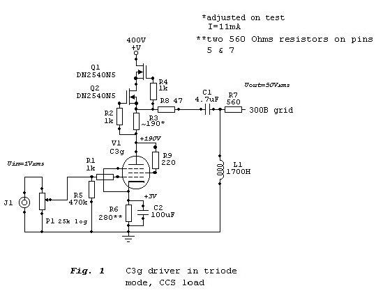

This is an Idea for a Mu-Stage based on the 10M45 chip in place of a Mosfet
(Ref: MU stage Philosophy by Alan Kimmel)
I have not tested this… need to order some parts.
Just wanted to get some feedback from any one that had made a SS Mu-Stage
In general… think this will work?
Also, if I understand it right, the Mu-Stage sets the current 3 or 4 times higher than what V1 needs, then just drains off the extra current via RS1 (the 42K in my schematic)
What is the benefit of setting the current 3 or 4 times higher and just draining off the excess?

Benfit is that anode loading is resistor to ground parallel with cathode resistance. More linear but less gain. Also without this resistor one would be forced to use DC feedback to set anode DC current of the same to CCS.

You would do a lot better using two 10M45S in a casocde arrangement (lowers the shunt capacitance) and taking the output from the top of the current set resistor.
The attachment shows DN2540 depletion mode FETs used in this manner. However the circuit is equally applicable to the 10M45S(an enhancement mode FET with an error amplifier which mimics a depletion mode FET). This arrangement works beautifuly and has a very low output impedance.

I think Doc B's bin' overdosing on the triple chocolate fudge sundays again ! The 10M45s has an impedance of over 10Meg over much of the audio range, and measures around 7 Meg @10Khz.
See this link for details
http://www.pacifier.com/~gpimm/ccs_performance.htm
This figure is substantially increased in the cascode arrangement.
As for them blowing up all the time, all I can say is that I have had zero failures in over 60 chips using plain old 510R carbon comps as 'gatestoppers'.

mach1 said:You would do a lot better using two 10M45S in a casocde arrangement (lowers the shunt capacitance) and taking the output from the top of the current set resistor.
Yes, I see that the output should come off the top of the current set resistor, and I will re-do my Schematic using 2 10M45's

With the schematic #1, the output travels from the plate of V1 through the 10M45 via a cupling cap, then out of the cathode "K" of the 10M45
So the 10M45 is acting like the top valve in a grounded cathode - cathode follower config.
Sqerus
You can take the ouput from the top or bottom of the current set resistor.
If you connect to the top you get a low output impedance a la mu stage - however the downside is that you lose the psu isolation that a ccs normally affords
If you connect to the bottom you get a high output impedance roughly equal to the tube's Ri - however the signal is isolated from the psu.
The two factors you are trading off are output impedance and psu isolatation. That's why I suggest that you try both and see which works out best in your application - it only takes seconds to change the connection.
