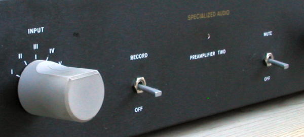

Peter Daniel said:Here's the sample of dry transfer on my BOZ. It was done in '96 and there is no sign of wear and tear. No coating done.
Where did you get those knobs?
Brian
Those knobs I bought years ago from my local surplus store. They come originally from Classe Audio preamps.😉
