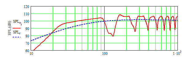

You tell me 😉, 32 Hz end loaded TL:
L = 102"
L x W (CSA) = 363"^2
CSA may go up or down depending on actual Vas or vice versa, and to keep acoustic gain high, a golden or acoustic ratio is required due to the relatively large CSA. Since this is for 'sub' duty, I assumed having the first notch around 100 Hz was high enough, and of course a high order XO is required to minimize the ripple's ability to comb filter with the mains.

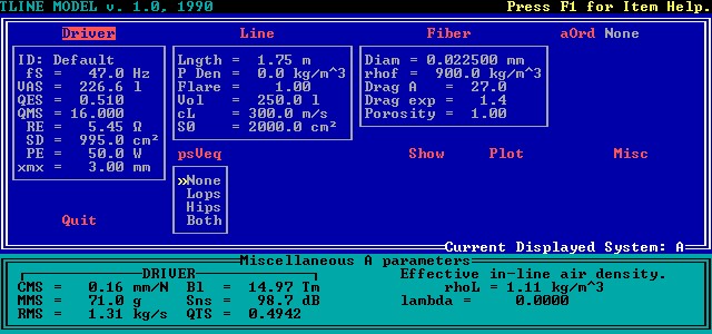

Today I found a freeware TL modeling program (I know... worth what I paid for it but it gives me a starting point) and I played around with it using my initial measurement/estimate of TS parameters and a preliminary design looks promising. In fact the results are good enough that I am somewhat skeptical. The resulting cutoff of about 28Hz is about 2/3 or 3/4 of an octave below fs which seems slightly (but not wildly) optimistic.
Given the params in the picture attached I came up with the following.
Line Length: 1.75m
Back Chamber volume: 250 (anything from 150 to 250 modeled well)
Pipe cross section: 2000cm^2 no taper
No fill.
Assuming that my estimated Xmax of 3mm is correct up to 8watts can be input below cutoff before exceeding Xmax. This equals about 106dB in the pass band (will low pass at about 60Hz). Above cutoff up to 40Watts can be accepted for about 114dB. If we can get close to that it should be very satisfactory in my 14x14ft room. Once built I can see if stuffing is of any real value. In simulation it caused significant droop in the low bass output but maybe just a trace to make sure that I don't get any high frequency noise out of the pipe.
I would like to build it into an old armoire that I have on hand. It is about 5'x4'x2' with an open shelf on the bottom and doors on the top. The plan would be to build the enclosure out of MDF inserted in the shell of the armoire with the doors solidly glued on (hinges removed). I would like to place the speaker on the lower right with the pipe going up and over to the left and fireing forward from the bottom left. The lower half of the armoire (below the doors) would be enclosed by grill cloth.
It just seems like this would be an fairly easy thing to experiment with compared to a horn loaded system and simulations indicate a bass reflex box would have to be over 20 cubic feet with four 3" diameter ports in order to get non-negative port lengths and similar fs.
Before building anything I plan to do a more careful measurement of the TS parameters to be sure of my starting point.
One thing I noticed in playing around is that reducing the Vas by half had very little effect on the simulation results. Is that to be expected?
mike

Greets!
Before we go any further, this looks like BoxPlot, which is a very basic T/S box calculator and the demo is a very early version with some bugs, so not to be trusted. If it's a TL designer, then where can I DL it to review since there's no way a ~69" long straight TL is going to have a 28 Hz Fp.
No, net Vb is in lockstep with Vas for a given alignment. Notice that with a 4 ft^3 Vas, the baseline efficiency is lower and the response is now underdamped since the pipe's net Vb is too large:
GM
GM

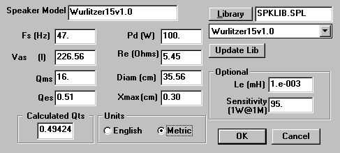

Sorry for the confusion. The pic is indeed boxplot. I used it to do the BR modeling and it was convenient to use the speaker window from that program to show the TS parameters. I actually used the DosBox (MSDOS based) TL program shown below to do the TL modeling.
mike
Opps, forgot the pic first time...
mike
Actually I just realized that I was changing Qms not Vas. Sheeze!

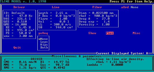

Anyway my confidence in this program is not too good because I put your length and pipe area into it and got wildly different results. Though the base output level was also around 100dB/watt I got a horrendous rolloff at about 55Hz and down 10dB by 30Hz!
This is the input screen for that run.
mike
mike

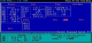

I played with the sim a little more this morning. First I corrected the speed of sound which they had at 300m/s (probably to account for stuffing which I wasn't using) and I get about the same results that you did if I double the cross section of the pipe to the 1800-2000cm^2 range. Sorry for the metrics but this program is all metric so I have to convert.
When I use the smaller pipe I get quite a bit of low frequency loss. Any specific idea of what could cause the difference in the results? What happens in your simulation if you increase the pipe cross section to 2000cm^2?
Thanks for your patience.
mike
mike

Greets!
A quick note: according to CONVERT.exe conversion program, 363"^2 = 2341.931 cm^2............
GM
GM
Remember the Daffy Duck Cartoon where he is working out with his buck and a quarter quarter staff and keeps hitting himself in the bill? Sometimes that expresses my life to a T. Yep, after wiping the sand out of my eyes and rerunning the conversion you are quite correct.
When using the proper speed of sound my program agrees closely with yours. I also find that it looks best with that large pipe and no extra back chamber. So the next step is to do proper measurements and model a version 1.1 enclosure.

mashaffer said:I actually used the DosBox (MSDOS based) TL program shown below to do the TL modeling.
Greets!
Thanks, I'm aware of it, but have never used it. I did all my personal TL designs long before it became available, so never had a need for it.

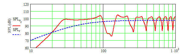

mashaffer said:Though the base output level was also around 100dB/watt I got a horrendous rolloff at about 55Hz and down 10dB by 30Hz!
Greets!
Right, without enough Vb for the driver to 'breathe' all the way down to Fp, it increasingly loads it with decreasing frequency. Once the optimum Vb is reached, any more just underdamps it.
That said, as the motor warms up, its Qes/Qts rises, making the driver want to 'feel' a larger Vb/lower Fp, so for high power apps this has to be accounted for if you don't want this acoustic 'choke' to protect the driver against overexcursion.
GM

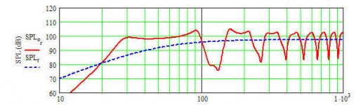

Greets!
The SoS/air density most folks use around here is 342 m/s, 1.21 kg/m^3 since MJK's Mathcad WSs are the standard, and up to a point of diminishing returns, increasing stuffing density actually increases the cab's apparent Vb, so you're on the right 'track'. Unfortunately, they are only ~accurate with polyfil, with fiberglass (my preference FWIW) requiring much less density for a given alignment.
GM
GM
