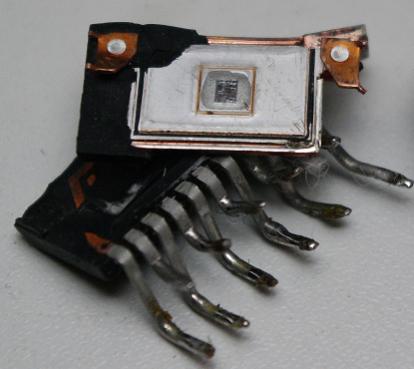

Picture of a Fake LM3886 (not sure yet, but probabily it is!)

Here is some pictures, I'll be glad if you give me some feedback, saying if it is fake or not.

It is difficult to say wether it is genuine or fake since you have busted it open before taking a photo of the whole case. As for the die, I am not sure how it is attached in the LM3886 (I could crack open one of my genuine ones, but I think I'll rather keep it in one piece 🙂 ), but it is not so uncommon to attach a die sideways if it makes it easyer to wire to the pin frame.

I have more two burned ICs, I'll open them. If they're just like the "fake", I'll open a genuine from farnell !
Better loose some money and know what I'm putting on the boards!
YES, they are fake !
There was no diference in the package, I placed the fake side by side with the original, and you can't see any diference.
I opened an 3886TF genuine, and I found what I was expecting. The genuine is better built and have the core perfectly aligned.

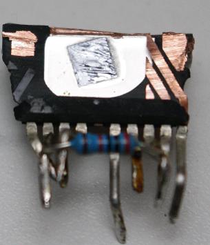

Ripped apart one.
The first is a genuine part from NSC samples program.Second - almost certainly fake. Notice the difference in die 🙂

Somewhere in the Forum an ex-National employee confirmed that the die is inclined as in your first photo, because that was the only way to connect the pins to the die.
Would be interesting to know, what the second IC is. Probably some TDA, and if you knew the pin layout, you might might even build a working chip amp with it.
