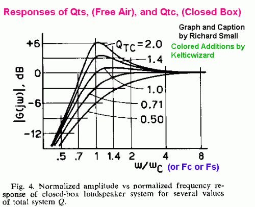

This chart gives you the response, whether in free air or in a closed box, of various of Q.
Free air = Qts
Closed Box = Qtc
For example, if the Qtc or Qts of your speaker is .5, you can see that it will be 6 dB down from the midpoint. Other values are given, so you can judge the response shape of most any speaker and box combo you are likely to encounter.
This is taken from an article in the Journal of The Audio Engineering Society by Richard Small.
The article is Closed Box Loudspeaker Systems Part 1: Analysis.
It is in the December 1972 issue. Also in the Loudspeaker Anthology Collection, Part 1 of the Journal of the Audio Engineering Society.
I took Richard Small's graph and caption and added some additional labelling, which is in color. Mr. Small is known for the Thiele-Small parameters, as well as many other pioneering contributions to loudspeaker design.
Free air = Qts
Closed Box = Qtc
