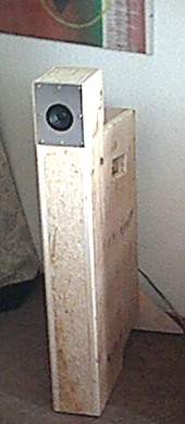

new horn idea, for two 3" driver with interlacing membran movement,
does this work down to 50 Hz with only
1 mm max. stroke?
105 x 13,2 x 54 cm
the last plan on the side:
http://www.hm-moreart.de/10.htm
to big to place it direct.
any opinions?
1 mm max. stroke?
105 x 13,2 x 54 cm
any opinions?
A very interesting design, and I reckon the radiation pattern it'll produce could be good. I suspect it might struggle to get to 50Hz, unless the line is completely dominant, but I bet it'd surprise a few people about how low it could go.
