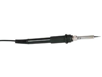

Ok, time to get some new soldering equipment and I would like
to hear your opinions/experiences. Unfortunately there seems
not to be that much to choose from here in Sweden. It is
basically a choice between Weller and Velleman, with a few
odd pieces of other brands. I find most Weller tools too
expensive for my purposes - I don't solder that much and that
often. So do any of you have experiences with the Velleman
soldering tools?
Soldering stations are nice, but how useful is temperature
control in practice? We can be sure not to overheat the
components, but if we don't use longer time than necessary
then the components will not have time to get too hot i think.
What about power? For a temperature controlled station I
guess it won't hurt to have much power, since we limit the
temperature, but what about non-TC irons? Is it better to have
low power (15 - 20W) or high power (50W)? This seems not
obvious, since a high-power iron does the job quicker with less
time for the component to get hot.
Are ceramic heaters better?
I want the ability to ocassionally solder SMT components, so I
guess I need a tool where sub-millimeter tips are available, so
some of the tools I am considering are:
- Velleman VTSS-20 soldering station 48W TC
- Velleman VTSSC-20 soldering iron 20W non-TC
- Weller SPI-16 soldering iron 15W non-TC
There are also some British-made irons called TCS which I know
very little about, but which seem interesting. One is a 50W iron
with adjustable temperature (looks like a trimpot in the handle,
so it is probably awkward), the other two are 18W and 25W.

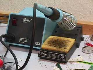

I bought the Weller WTCPT soldering iron. It does very well in maintaining a constant tip temperature (you can buy 600, 700 or 800 degree tips for it). It has a closed loop method of keeping it within a couple of degrees of the maximum temperature. I got it for a little under $60 when the radioshack store here was closing.
It is also the one that my school uses for all of their labs.
Brian
Brian

I like my Weller station as well (WTCP-S).
The only disadvantage I see at work:
When it comes to repairs (magnetic switch, heat-element) it can get really expensive.
A friend of mine has an Ersa station which works really well.
For the price of a standard Weller station you´ll get one from Ersa with adjustable temperature. Just a thought..
Ersa soldering technique
Jens

Is there nobody who have tried the Velleman tools? They seem
to be sold everywhere nowadays and there are a lot of models
to choose from.
