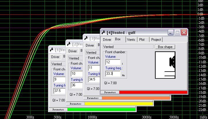

Plugging the PR specs into winISDPro driver editor gives a Vas of 40L.
This is very reasonable. The typical mass of a 10" sub cone is ~ 100g,
so the supension with a 100g cone would give a driver with an Fs
of 32Hz, as the PR cone is 400g, Fs = 16Hz.
Given the Vas = 40L I them manually calculated Fbox as though it is
a sealed box giving Fb = 9L/37.5hz, 10L/36Hz, 11L/34.5Hz, 12L/33Hz.
I then modelled it as a vented box using averaged specification
and measured values for the 8" MCM main driver.
As far as I can tell even if the Fs of the PR is way out, as long
as the PR mass and Sd is correct it will make little difference.

P.S. my estimate is you'd need a cone mass of ~ 500g for
32Hz in a 10L box (including the PR suspension stiffness).
I suspect your calculations have mixed up a radius
and a diameter giving you 100g instead of 400g.
