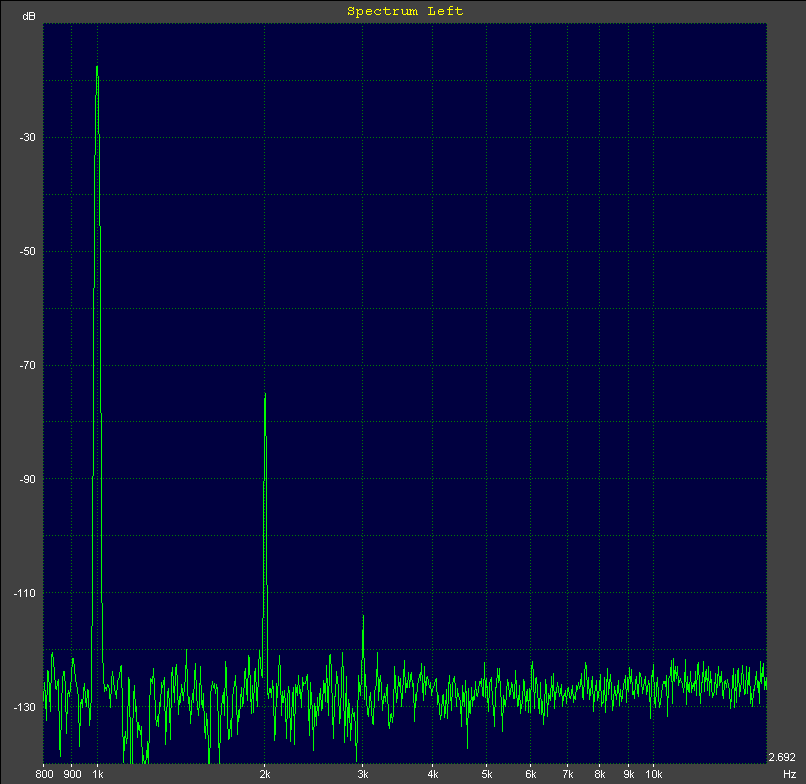

A friend gave me a couple sleeves of these still common and popular-with-hams triodes. The plate curves looked promising. Attached below is a spectral analysis, conditons as noted in png name, of an RCA 955 driving a 200 kohm load 23 volts p-p, max requirement for my EL84 SE. 2nd harmonic is about 0.12 %, third 100 dB below fundamental. Not quite as low as the 6C45 currently in place but the 955 seems to scale nicer. 45 volt p-p raises THD to 0.25% second, third 100 dB down. 6 volts p-p results in 0.03% 2nd, 3rd below the noise floor of my kit. A Raytheon has 70% the 2nd but shows a little fourth.
Rp is a bit high at ~11.5 kohm under these operating conditions but no deal breaker for an EL84. Has anyone tried them in a circuit and have an opinion on sound?
