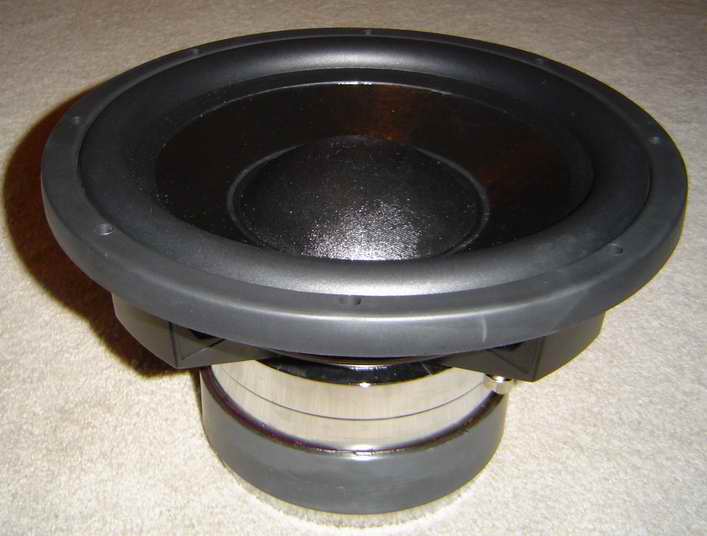

Hi All,
The drivers are in (finally). I am very pleased with the build quality of these units - A1! Not only that but in my request to get single voice coil units, something happened in the "translation" and I ended up with dual voice coil drivers. Call it a no-cost fringe benefit...
Here are the T/S parameters for two of the models thus far (measurements taken after trial burn-in). Punch in the numbers and see if they work for you!
MAW-10
Fs = 25.94 Hz
Re = 4.40 ohms[dc]
Qt = 0.36
Qes = 0.41
Qms = 2.97
Mms = 98.51 grams
Rms = 5.398339 kg/s
Cms = 0.000382 m/N
Vas = 37.96 liters
Sd= 265.90 cm^2
Bl = 13.133653 Tm
ETA = 0.16 %
Lp(2.83V/1m) = 86.62 dB
Xmax = 10 mm
MAW-12
Fs = 22.90 Hz
Re = 4.30 ohms[dc]
Qt = 0.38
Qes = 0.43
Qms = 3.34
Mms = 137.13 grams
Rms = 5.904246 kg/s
Cms = 0.000352 m/N
Vas = 83.34 liters
Sd= 410.43 cm^2
Bl = 13.971972 Tm
ETA = 0.22 %
Lp(2.83V/1m) = 88.25 dB
Xmax = 10 mm
Mark
