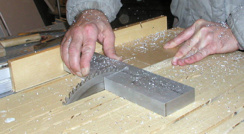

I ran out of excuses for my lousy woodworking, so I decided
to try metal fabrication. This way I can make a bunch of mistakes
and blame it on lack of experience!
Here is my first attempt at cutting aluminum.

Clamps!
Make sure to clamp the hell out of everything. I clamped on both
sides of the cut.
sides of the cut.

The blade was a 10 inch, 80 tooth Freud carbide from Home Depot.
It specifically calls out "Non-ferrous metal" onthe blade. $55 or so.

Of course, you have to use some form of cutting fluid. Here is what
I used...
I used...
Here is a picture of the whole setup with a finished cut.
I've always had decent success with a regular cross-cut blade on the table saw, and no cutting fluid. Not that a non-ferrous blade isn't somewhere on the desired-tools list - but it's not a necessity.
Those chips do fly.
Those chips do fly.

You can cut 2" plate on a good tablesaw... just go slow.
Everybody keep in mind... you CANNOT do this with just any aluminum. You must use "free-cutting" grades. Purer alloys of aluminum are gummy and will not cut like this.

This is the blade for my 10" sears tablesaw. Freud makes excellent blades - I have wood/laminate blades also. Highly recommended!
Works like a champ. I use WD-40 as lube. I've even cut AL up to 3/8" with no problems.

Aengus,
I agree with you 100%. The blade looks virtually identical
to my Freud (wood) finish blade. Now that I have some
experience, I would use it for this thin aluminum. I am
not promising the same blade life, and your future
finish cuts in wood may suffer a small amount, but it would
definately work!
Also, the lubricant is probably just helping the life of
the blade. I'm fairly sure the cut is identical with or
without it.

Poobah / Kec,
I am too chicken to try this on a table saw! The chop saw
rotation has the blade contact PULLING the piece into the
fence. On a table saw, the contact is (somewhat) PUSHING
the piece back at you. Do you wear cast iron boxer shorts
when you cut?
