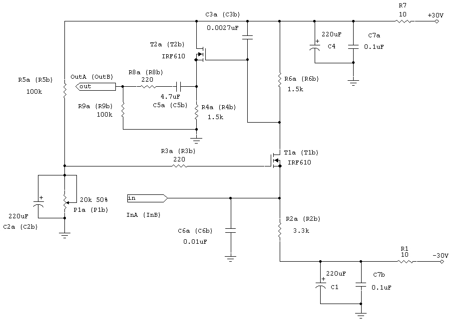

Assuming that I have 0 volt out from the DAC, what do I have to change to the circuit to use Lovoltech Jfet instead of IRF610. My thinking is that I need to change the two 1.5K resistors to a different value to bias the Jfet? The schematic that I am looking at is attached.
JFET Vgs is negative, unlike MOSFET, so instead of tying r5a to +30 tie it to -30. The 1.5K resistors control gain, not bias, to change current bias change the 3.3K resistor.

Thanks for the link. I may be totally wrong here as my sand knowledge is horrible. I think Stefano implementation is different than Promitheus's circuit (the gif that I attached). In P's circuit, T1b has a 1.5K resistors on the drain (top) and an identical 1.5K resistor is placed on the source (bottom) of T2b. The output of the entire circuit is taken off the source of the second(following) Mosfet. This reminds me of the Aikido stuffs over at the tube section.

Values depend on devices selection , anyway inserting the lovoltechs in the original circuit - I have slightly lower rails- will find out they are working at Vgs about -2.1 volt , and Vds around 8 volt .
Having DAC dc point as high about 2.5 - 3,5 volt the gate of the cascode jfet will be at a positive voltage .
If the DAC works at 0volt the Jfet gate will be at -2.1 volt or so .
I am tempted to raise the gain a bit , using R6 at 1.8k or 2.2k .. will see .
In that case will be necessary to change the bias (R2) in order to let the buffer have a nice working point also .

2 x PCM1794 + D1
I adjusted the original D1 output stage to two PCM1794 in mono-mode. You have to get 2.4V at IN and a quiescent current of about 17mA.
The 100k between pot and "+" replace by 68k to get the offset. For the current instead of 3k3 to "-" use 2k, instead of 1k5 to "+" use 820R. Actually I have 1938R and 857R by adding parallel resistors (4k7, 2k), which is better because they have to burn a little over 1/2 W.
