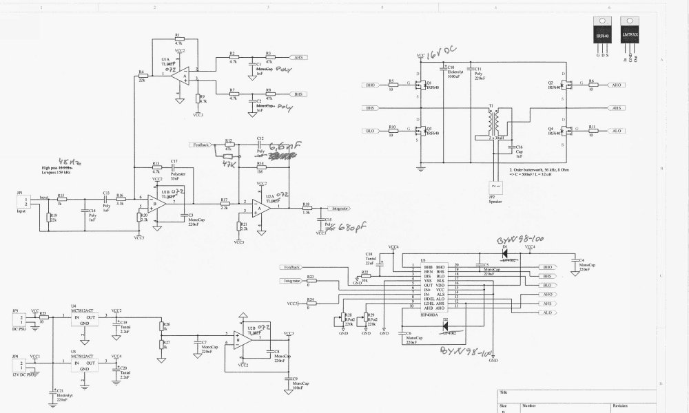

I have been building on my first class-d circuit for some time, and have had really good help by reading the pages here on DIYAudio.com 🙂
I started building the amp on a breadboard, and eventually it worked fine. Only problem was a kind of white noise, which was always present.
I thought that a real PCB would cure that, and it almost have, but it is still there to some extent!
Also when playing at very low levels the bass notes have a sound like clipping or metallic (a bit hard to explain in words)! Maybe it’s just the noise that is "modilated" in tune to the music
Also it is very sensitive to touch; If I place a finger on the driver IC (HIP4080), when it is not playing, the noise almost disappears, but placing a finger on one of the caps that controls the PWM freq, does the complete opposite.
I have done some measuring with a scope (Se my homepage ) and nothing really sheds any light on the problem!
I’m pretty sure that the problem is to be found around the PWM oscillator.
Could also be a fundamental grounding problem (Using a ground plane split into two to kind of separate analog from digital).
I'm using a virtual ground for some of the circuit, but as can be seen on my homepage, the "noise" on this ground is not at all alarming 50 mV pp)
Have tried to use NE5532 instead of TL072, but the integrator in the PWM ran pretty hot, and it was difficult to adjust freq. down to below 300 kHz.
The amp is running on a small 16 V DC PSU (until I know it is working properly 😉 ).
The amp is intended for a subwoofer, and hope to get it to deliver more than 300 W …. Eventually 😎
The pots for adjusting the dead time is set to 220 k for maximum dead time.
Anyone who has any ideas??:xeye:
(Se attached diagram)
(Se picture of amp on hompage as well)

Well, I have played around with a few components, ending up with changing the loop resistor around the PWM stage, back to 47k, changing C12 to 1nF and C15 to 680 pF, and pacing a 4p7 ceramic between pin 5 a d 6 on the HIP (slowing the internal comparator down a little). This has almot cured the problem. The brake came form using the 4p7 ceramic on the comperator.🙂
(The switching freq is now around 225 kHz, and the sound is good, though there is still a bit of noise when no music i palying)

Have tried out a few things:
Mounting diodes parallel with the gate resistors (1N4148) have helped a bit with the noise, and defenetly with the heat disipation, especially in the LM7812 regulator the the driver IC! :cannotbe:
Adjusting the resistors for delay on pin 8 and 9 from 220k to 115k has reduced the noise to a mere humm (not white anymore) which is affected bu tuching the ibput components (more of the same noise)
A 470 uF decoupling close to the Vdd/Vcc of the HIP is helped too.
More decoupling on the virtual ground does not seem to help any. But then again, I havent tried omitting the buffer as you suggested Brian ..... a bit too dificult on the current PCB 🙁
All in all, noise is down to almost nothing. Next step will be to raise the supply voltage and se what happens 😎

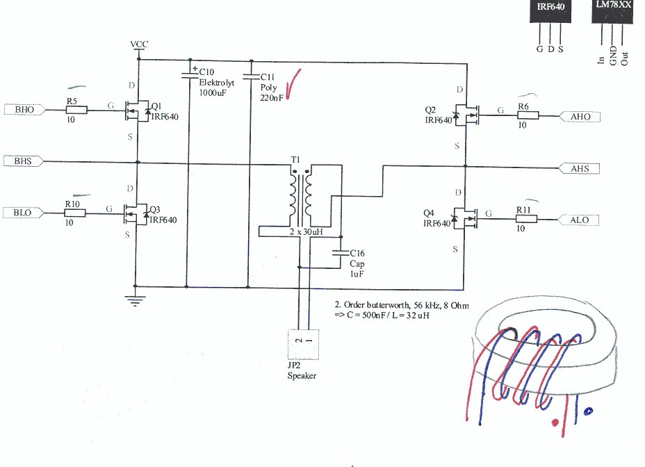

But the output coil is getting dangerosly hot!!!!!:hot:
Just by switching! Signal/music is coming through no problem, but the switching frequency has changed to 140 Hz (se scope shot).
The two coils for the diferential filter is wound around the same coil former (a former I had laying around .... think it must have been used in an SMPS as it had two windings, 2:1) and has 2 times 18 windings giving 2 times 30 uH. (this should mean that it's permability is rather low, and I gues therefore well suited for this application).
The colils are connected so that the current through these runs "the same way" building on the same magnetic field.
...... is this a no go???

I have made measurements on the coil, by making 8 turns with a wire round it and measureing with a scope. At 17 V it seems to work just fine, and is connected correctly. As far as I can see, the ICEPower modules are also using one core ring for both coils .... guess it's ok if you use the right core material 😉
Anyone know a good online store where thay have a good range of suitable ring cores?
Iron powder losses are strongly dependent on volts per turn, more than on frequency or any other parameter. Use more turns and core heating will be reduced. You will have to figure out how to manage the extra inductance, though.

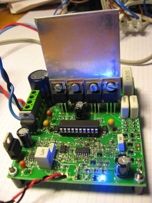

My full bridge HIP4080A SODA is coming along quite well.
No more noise 😀
It's running on +54V at the moment. Next step is putting a 500VA 50VAC + 22000 uF Rifa on and put it to good use in my Peerless XLS sub 😎
Still som improvements could be done, but I think I'll move forward on another project instead! 😉
More infor on my homepage:
http://home20.inet.tele.dk/audio/HIP4080_SODA_Class-D/hip4080_soda_Prototype2.htm
