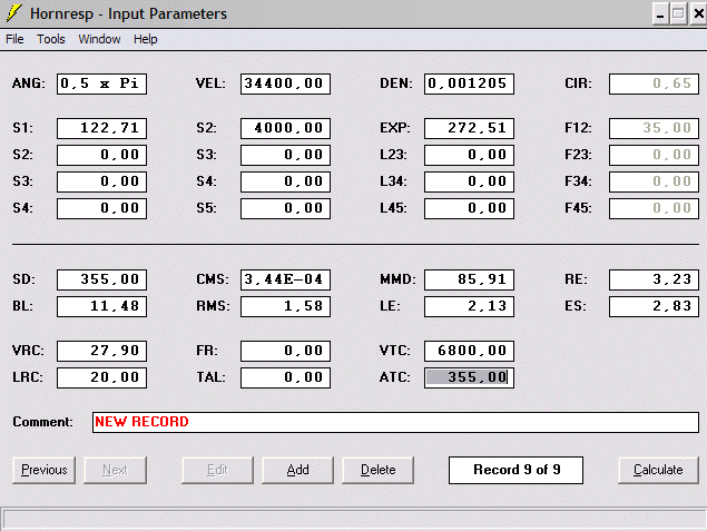

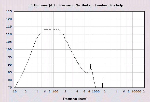

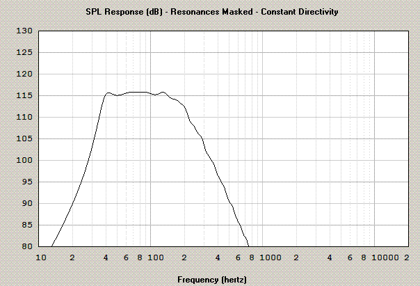

Anyway, your woofers could go that low when horn-loaded. I quickly simulated a possible alignment (see attachment). I reduced the mouth area somewhat to keep the size down.
Wow, I did'nt realize it would have to be so big. Thank you for simulating it. Does HornResp also do folded horn designs? I think this might be a better option for me.
Nichol1997 said:Wow, I did'nt realize it would have to be so big. Thank you for simulating it. Does HornResp also do folded horn designs? I think this might be a better option for me.
If the horn's still too large, you could reduce the mouth area some more. However, if you want 'flat' frequency response you should increase the horn's cutoff (higher F3), because a horn reproducing the 30 Hz region simply needs to be very large.
You could take the calculated values for throat area (St or S1), compression chamber volume (Vb or VRC), the length of the horn etc. as a starting point. Then you could design a folding pattern to fit the horn into a cabinet. It's important to maintain the horn's expansion through the bends.

I calculated the throat area with Keele's math, a CR of 3:1 should be low enough for the driver to work as intended (depending on the voltage level at which it will be driven).
Together with a throat chamber set to the horn's upper cutoff frequency (Fh, in this case 150 Hz), the FR becomes quite flat.
I chose 35 Hz as the lower cutoff frequency (Fl). The rear compresson chamber Vb was also set to this frequency.
ATC is the 'surface' of the throat chamber, in square cm.
Of course the design could be improved, it just was a quick simulation.

Because a picture says more than a thousand words, just look at the schematic diagram and change ATC to see what exactly changes.

I just input that Eside data and sure enough there was a front chamber in the sketch. Thanks Rademakers.
My big horns suppressed the driver end of the diagram to insignificance and hid too much from view. Just shows what happens when one becomes blinkered!

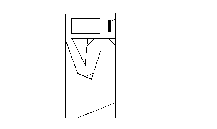

I found a design that I like on William Cowan's site, the "Horn Sub Jr."
http://diy.cowanaudio.com/
Will my JBL's model well in this enclosure? Can someone post the frequency response graph? I am thinking about doing the exact dimensions since he has calculated everything already.

download hornresp, it's free.
Put in the same info and see the graph.
Then substitute your own speaker data and see if anything changes.
Now omit S4 which is a guesstimate for corner expansion for that last metre and see what the graph looks like.
Take care to read the whole of Cowan's page, there are many pertinent pointers to obtaining adequate performance from his junior horn.

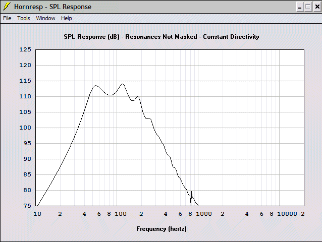

Nichol1997 said:I found a design that I like on William Cowan's site, the "Horn Sub Jr."
I simulated your driver in the Horn Sub JR, see attachment for frequency response. I think you want flatter response, so you may try other designs. Personally I like the folding pattern used in this horn...
G'day Nichol1997
Your JBL drivers actually appear to work quite well in my little basshorn. The specs of your drivers are very similar to the Etone drivers I'm using. If you build this horn with your drivers and placed it firing into the corner of your room (Assuming a domestic sized room) you will obtain a flat response to a bit below 40Hz.
My inroom measured response is +/-3dB from 34Hz to above 100Hz. This is actually better than the horn simulates in hornresponse.
It is an easy horn to build, I see you have little to loose.

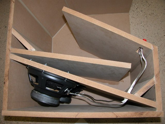

Old post, but I thought I would give everyone an update. I finally got around to building them to Cowan's specifications. Well not exactly, the depth of my enclosure was half an inch less than Cowan's. This happened when I switched everything to English units and did not double check my work. Oh well. I have them hooked up in series to a Behringer EP2500 and I am quite pleased with the performance. Real clean and loud.
In fact, they are just as loud if not louder than my pair of Ascendant Audio Avalanche 18" drivers that are housed in a bass reflex enclosure tuned to 14 Hz.
I have not measured them with a SPL meter but I plan on doing so in a few weeks. I hope I don't have any peaks.
