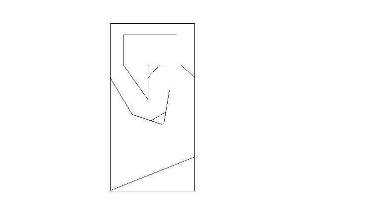

Under construction pictures of the alpha 1.2.1 are up
http://www.planet10-hifi.com/alpha121.html
dave
dave

Okay, now I can see the trick and importance of this special backloaded "hornmouth" - because of small size and therefore close coupling to the wall it gets very tight to the wall - the way the mouth opens wide gives more air between the wall and "hornmouth" - actually I have seen a backloaded Buschhorn made exactly this way.

After a short listen this afternoon, Dave has already started ruminating on revisions to the plans that would make them a little easier for someone with limited machine access to construct... (i.e. fewer acute angles
The first conclusion from today's listening session is that the list of "frugally priced" drivers appropriate for this niche is probably very short, (and is brought to you by the letter "F"), and while intended to allow maximum driver flexibility, the CC as per original drawing is probably oversized for the 2 major candidates.
My personal second conclusion is that there is a pattern of synchronicity between any of the 4" Fostex FR drivers and a decently executed SE amp (in this case an "RH" EL84, implemented with all Solen film power supply caps and parallel feed )

George, if the Fostex recommended design you're referring to is the hybrid mini horn/BR, yes we've built a pair.
If I might speak on Dave's behalf, let's be nice and say that for someone considering them due to the size, and with at least 10w of power, the FE127 in the folded monopole MLTL would be a much better bet - and easier build.
In a brief initial audition yesterday afternoon we did play the FrugelHorns with a powered sub, (bipole Adire Extremis 6.8 in small ported enclosure) both with the horns full range and through the HP filter. It definitely adds a substantial foundation to the music, but as always, there's the issue of seamless integration and the disparate "signatures" of the electronics. For my taste, this sound is fine for home theater/video which is all about sounding bigger than life, but after only a few dozen minutes of music alone I develop listener fatigue.

Guys,
The a121b build does not suck (i was not in a frame of mind to get into critical listening last night, but there was a period during at least a track or 2 of the Wailing Jennies where time just dissappeared... )
This build showed up some actual construction issues, which we'd like to remedy before widespread distribution of plans.
If anyone wants actual plans you can mail me (as i did promise to release them if our build didn't suck). As i believe there are some easy improvements to be made, i'd like to keep a handle on who has a121 plans and would suggest that, unless you are REALLY eagar, to wait till the next alpha version at least (alpha 2.0 is drawn and off to Chris for constructability considerations & to Scottmoose for simulation -- kudos to Scott for taking on this task).
I also forgot the camera last night so have no pictures to offer (i will get some, these are so cute -- the last a blessing & a curse ... huge WAF, but some will look at them and dismiss them as not to be taken seriously). In-room measures (with my crude system) will also be done.
