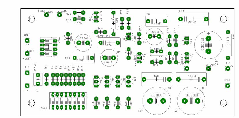

I started a new thread for this new project.
I am making PCBs for an MC Pre-Premplifer to be used with the Pearl Phono Preamplifier.
It will be powered from the Pearl and can fitted on top of the Pearl.
I will be posting more information here like PCB layout parts etc.

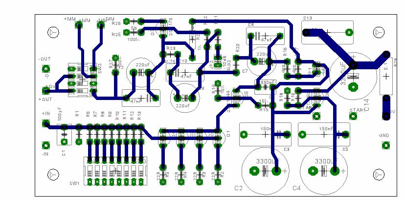

This is what the Board will look like.
I still have to check the Layout one last time.
If anybody sees a mistake please point it out.

63mm x 126mm
The Board fits directly beside the big Caps C7, C8 and C15.
But it must be placed above the MKP output Cap C9.
The best would be to use an extension screw on the left bottom corner. The other 3 corners could then be placed on adhesive plastic PCB mounting things.
I don´t know if it is possible to mount the PCB on top because the output cap is too big in diameter.
That means the board must be lifted at least 30mm.
I dont know if it possible to make the PCB even smaller.
It would have to be 10cm long.
Thats not possible I think.
Do you have any other ideas?
Promitheus,
It looks like it will just fit. The height is very tight, but I think it will work. If necessary, I can mount the 3300 caps on an angle.
Are there enough people interested to make it worthwhile making the boards?
I'll mount it above the input section of the Pearl, with the long edge parallel to the long edge of the Pearl.
I'll extend the corner mounting post of the Pearl to the appropriate height and mount the corner hole of the MC board on that. For the other corners, I'm not sure. If possible, I will drill a hole in the Pearl PCB and screw a standoff there. But if there are tracks in the way, then I can glue a nylon standoff on top of the Pearl at that location.

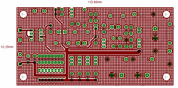

Do you have a way of combining the corner of the Pearl etch pattern with the MC board as a single image so the alignment can be checked better? I don't think I have tools to do this. Or maybe combine the two component overlays into a single image to see what conflicts with what, if you line up the two corner holes. Do you know what I mean?
Well actually, if you can send them both as .jpg files at the same scale, I can do the overlay with photoshop and check it that way.
Also a new question: The MC output is now coming out close to both the MC and MM inputs. Is that going to affect stability of the MC stage, or even the MM stage?
