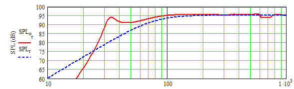

el`Ol said:
One example:
The Eminence Legend 151 with Fs 82Hz makes 34 Hz in a 360l Onken with Port length 31cm and port crossectional area 85% Sd at Onken alignment.
Greets!
Did you sim it? You'll have to stuff the vents solid to get rid of that peak, so might as well build a sealed cab and save yourself the extra woodworking.

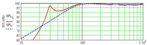

panomaniac said:
Cool! I also ran the spreadsheet on the Selenium 10PW3-SLF 10". Looks like it might work.
Greets!
The Selenium's Qts is a bit high too. Remember, if a higher Qt driver doesn't sim well in a BR, the Onken's large vent area will only make it worse.
To keep the vent length <35 cm, I had to use n = 7 and only 75% vent area.
GM
