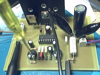

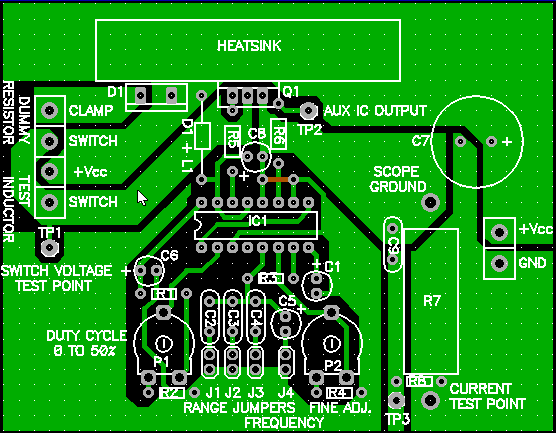

First, this is the PCB design, it has been corrected to show the patches that I applied to the first PCB:
Don't ask me for a schematic because I don't have any, but with the previous picture, SG3525A datasheet and the following part list, it can be figured out quite easily:
Quantity Type/Value Ref Designators
9 JUMPERS J1,J2,J3,J4,TP1,TP2,TP3
3 CONNECTORS K1,K2,K3
1 3.3u C1
1 1n C2
1 10n C3
1 100n C4
1 1u C5
1 10u C6
1 >2200u 25V low ESR C7
1 100u 25V C8
1 10n (depends on R7 ESL) C9
1 10uH >0.2A (in series w/1N4148) L1
2 4k7 R1,R2
1 68 R3
1 2k2 R4
2 22 R5,R6
1 0.022ohm non-inductive R7
1 100 (depends on R7 ESL) R8
1 4K7 P1
1 47k P2
1 60V 60A <0.020 ohm N-CH switching MOSFET Q1
1 MUR820 or similar D1
1 SG3525A IC1

A very low value current-sense resistor is required for R7. Also, R8 and C9 form a low-pass filter that cancels the effects of R7 leakage inductance, thus their values have to be tuned depending on the particular resistor model employed (mine is from SBL4 series from Meggit Electronic Components and the values shown compensate it quite well).
A heavy duty low-ESR high ripple current SMPS capacitor is required for C7, mine is a Panasonic 2200uF 25V rated at >6A rms ripple at <45ºC and >10Khz, and featuring 0.022ohm ESR.
A dummy resistor of suitable value (connected as the PCB text shows) is required to dissipate the energy stored in the inductor during the switching pulses, 1 ohm 6W suits well measurements up to 40A, altough higher values are required to get reasonable reset times when the currents involved are very low. To measure inductors supposed to have very high saturation currents, it's preferable to temporarily double the number of turns, so that inductance gets multiplied by 4 and saturation current gets halved. The I(sat)^2*L product will still be the same, as it depends almost only on the size of the core and the length of the air gap (for ferrites), allowing to predict turn counts and saturation currents for other inductance values quite easily.
In order to use the circuit, duty cycle has to be adjusted below 0 (to prevent switching, achieved by turning the pot. full anti-clock-wise), then the test inductor has to be connected and power has to be applied (a 15V >1.5A well regulated supply is recommended). Then, the duty cycle has to be slowly increased (by turning the pot. clock-wise) while looking carefully at the current and voltage waveforms in the oscilloscope (that in turn will tell almost anything about the inductor). The waveforms should look like the following ones (there will be some ringing after transients because I was too lazy to add damping). Note the scales:
Before trying to further increase the duty cycle in order to find out the saturation current, the frequency has to be adjusted low enough to allow the inductor to fully reset before the next pulse begins, and it's recommended to switch power off while changing the timing capacitor jumpers. The following picture illustrates proper inductor reseting, see how inductor voltage has completely fallen to the 15V supply voltage level before each new pulse starts.
Using a higher value dummy resistor will provide faster resetting but at the expense of a higher voltage spike, so care has to be taken to not destroy the switching MOSFET due to excess avalanche dissipation (it has never happened to me, though).

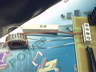

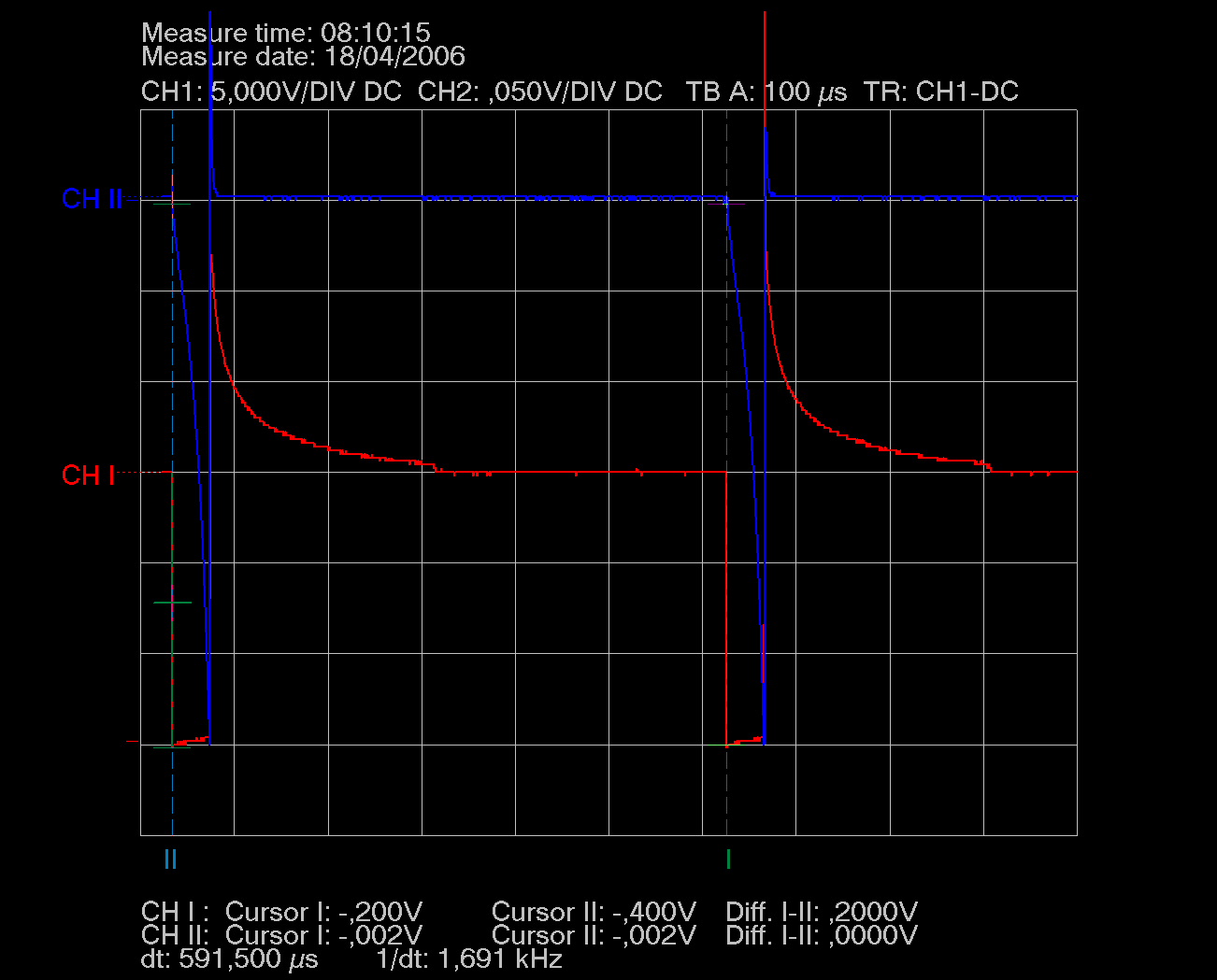

In order to calculate inductance, the first thing that has to be kept in mind is that its value is not constant, it's a non-linear parameter and it's always current dependent, particularly for iron-powder cores or anything involving iron (only air cored inductors are believed to be truly linear, but they create high densities of flux lines up to quite far in space, so any close ferrous object will make a measurable difference). Being aware of that, the average inductance between two instants t0 and t1 is calculated by dividing the voltage applied to the coil (that must be as constant as possible) by the current slope:
L(t0..t1) = V / ( (I(t1) - I(t0)) / (t1-t0) )
or:
L(t0..t1) = V * (t1-t0) / (I(t1) - I(t0))
Note that at high currents the voltage drops across the sense resistor, the switching MOSFET and the capacitor have to be taken into account because the voltage applied to the inductor is no longer 15V during most of the time. I usually take an average of the initial and final values, something like 14.5V
In the previous example, we could assume that the inductor starts to saturate when the voltage drop across R7 exceeds 120mV, so the Isat would be:
.12/.022=5.4A
Note that iron-powder cores produce very progressive saturation knees, while gapped ferrites tend to be quite abrupt, particularly with small gap lengths.
Also, according to the waveforms, the current takes 23.3uS to rise from 0A to 5.4A, so average inductance in that region would be (using the previous formulas):
L= 15V * 23.3u / 5.4A = 65uH
That's all. BTW: I wound that inductor to be rated at 68uH 5A so it's quite close to spec 🙂

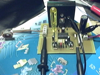

Finally, these are some pictures showing the previously described measurement setup:

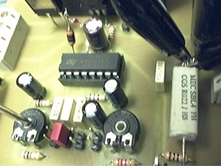

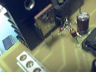

Update:
I finally blew my ancient STP60N05-14 MOSFET after years of abuse, so I replaced it with a IRFZ48V (72A .010 ohms) wich handles high peak currents much better.
I added a "double barreled" ferrite bead in series with the gate, and then the old 22 ohm resistor in parallel with a 11DQ06 schottky for faster turn-off. The ferrite bead suppresses RF ringing and actually speeds up turn on and turn off transients (due to resonance with gate capacitance), although a small delay is introduced (not a problem). See picture:
The main PCB tracks were reinforced with solder to reduce parasitistic voltage drop and get a more precise measurement. See picture:
Finally, I also added to 4700uF 35V capacitors to get less voltage drop when dealing with low voltage high current inductors (50A measurements are more precise now). See picture:
Another small modification was to solder the sense resistor (.022ohm 4W non-inductive) sitting on the PCB rather than lifted. Leakage inductance was reduced as a result.
