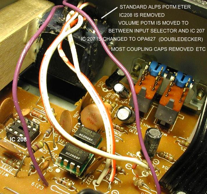

Does anyone know how to replace the NAD 1300 volume/Balance pot. It is a combined pot, wich conbalance and volume.

I used a standard ALPS potentiometer. Since it does not fit the usual way, I simply glued it with epoxy to the inner side of the cabinet together with a piece of hardwood. I was only glad to get rid of the balance potentiometer, I have never used them.
The picture suggests some other changes, as you can see. The only active circuit in use in the amp is the opa627. This simplification has allowed me to throw out, or shorten, most caps and switches in the signal path. (I have lowered the supply voltage to the opa somewhat).
Everything has worked to my complete satisfaction for a couple of years

can i anyone help me out wich is the value for balance and wich is for volume?
Thanks Sletol for posting your picture of your mod. From that picture I coould extract what you did and do it myself. It's a great mod!
sorry gy21 for answering your question about the potm size this late ( You already figured out that the size is not critical, of course), but I believe I used 50k.
I am happy (and somewhat surprised) that you could make use of the photo for the other mods!
