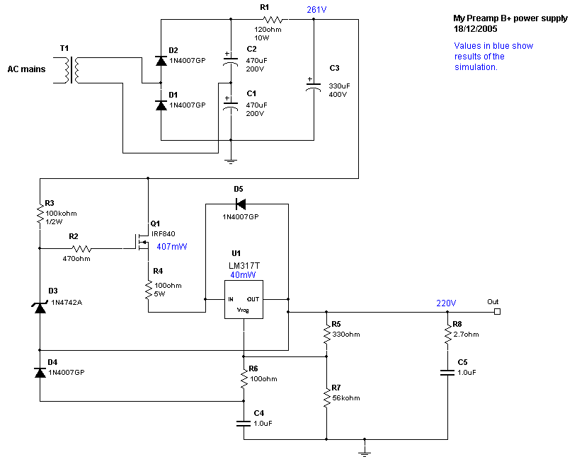

Filament supply: no schematic, just a bridge rect, 100nF, 4700uF, 4R7 and 12AX7 filaments, wired in parallel with the series of the ECC88 heaters (to get 12.6V).

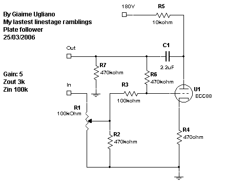

That line stage has its roots in the requirements I had when designing it, it can provide all my goals in a very good way.
It had to be:
- some gain, max 5 not more
- high input impedance
- low output impedance (it has to drive power amps directly)
- low distortion, low coloration
- only one tube, and better if ECC88.
You'll see that with those requirements it cannot be much far than that 😀, maybe a step up trafo and a CCS-loaded cathode follower would do, but I'm cheap I don't have money for trannies
So I developed it thanks also to TubeCAD: that circuit is listed under "Plate Follower" circuits.

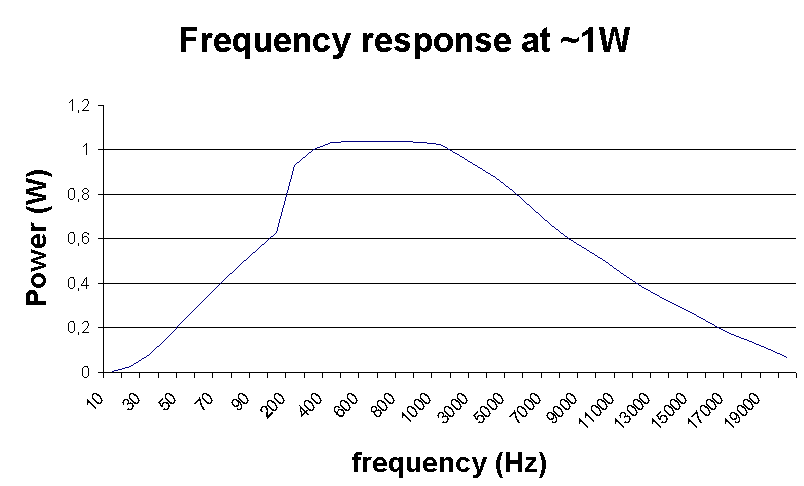

Money is not too much... I'm now listening to a 1.6W triode connected EL84SE. Sound is good, but frequency measurements show a not-so-hi-fi response...
I do live in a 220V country, and I must admit that 250mA fuse blows, but I'm using fast ones. I'll get some retarded ones and try. You're right, obviously. On more "expensive" project I'll fuse everything on the back panel (both mains and HV, and if it's an amp I'll fuse EACH output tube).
Haha! I must admit that your freq. response once and for all says that it is the ear that make the final desition. I always trust my ears.
My 6L6 amp has around 1-2w ouput, it is becouse of the opt. I wound them my self. 🙂 But they are very good. Freq response was almost flat from about 35-23khz. Very little ringing too. But they are very, very ugly. I have no idea how much dist. my amp has, but for me it sounds good.
