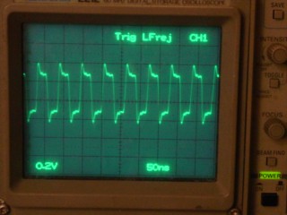

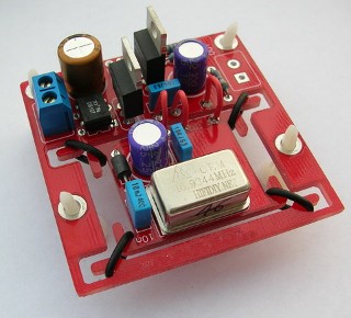

I purchased a clock kit from China at around US$15 + US$1.5 courier charge to Hong Kong that includes PCB, all components, a "so to say" 10 ppm oscillator and a 2VA transformer. After assembling, I measured the output voltage and it reads 2.5V but my oscilloscope reads overshooting. I am fighting if I should put it in my antique - Pioneer T-07A which has been in my service since 1990. Eventually, I used 3 hours to install it.

1. What causes such overshoot?
2. Does the overshoot hurts?
3. How to kill the overshoot?

You need to ensure that the clock output impedance is matched to the input impedance; try terminating into a 50R or 75R load.
You can kill some of the overshoot by mopunting a small capacitance across the output. Apparently some XOs like a bit of capacitance say 10 to 47 pf.
The clock looks quite well made. Can you give me details and I may order one myself.

The suspension made me chuckle, so little mass so the resonant frequency is going to be quite high.
Hi.
Agreed but it shows that some thought has gone into the design.
It does look well made. If we had some conponent values and a shot of the underside, we could reverse engineer the circuit.

Thank you for all the input. The measurement was made without loading. I will measure it when it is in operations. Yet, I still wonder should I install a more expensive clock in an attempt to even improve better?
It is not the cost, but the phase noise. No point in using a very low TC clock with poor jitter performance!

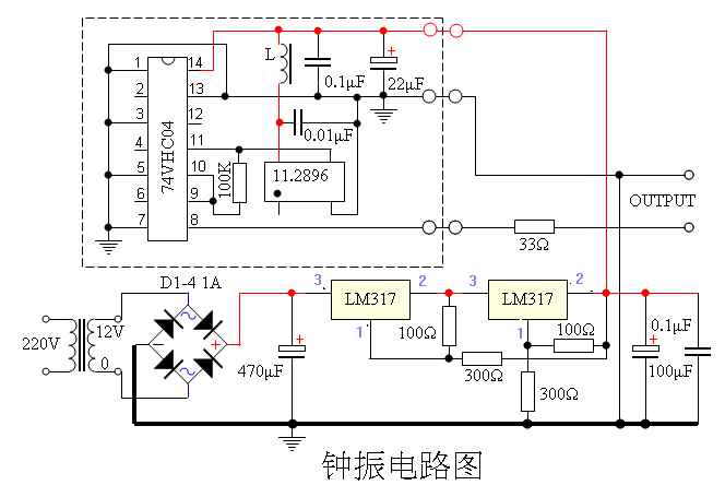

If the circuit posted is the one you have, the clock signal is not coupled direct but relocked.
Now is this shiny square thingie a crystal or a crystal-oscillator????
[ I guess it is a complete crystal-oscilator as it is powered from 5V supply. So information given is plainly wrong]
74VHC04 oscillator is not much better than standard in CDP.

PCB suspension seems to be directly stolen from Madrigal Audio Systems. Shall I give them a hint? One or two LM317 NOT low enough noise IMHO, especially as Vadjust pin is not bypassed. See link in post # 15.

When the Jung regulator has been improved so much (ALW version), there is to me NO reason for going so far to canacel out noise, and with a highish output impedance too. I have obtained easilly<10 uV/1MHz with the Jung circuit.

1) There are clearly better voltage regulator circuits than that. It seems to be more complex than it has to be and uses OLD regulator technology versus new. Have to wonder why...
2) The 4 pin CAN is clearly an a self contained crystal Oscillator which means it has "very stable consistent TTL level output" if it's not overloaded.
3) The 74VHC04 is clearly just a wave shaper and buffer, nothing more. It is not the Oscillator portion of the circuit at all. It may even be contributing to the overshoot. Nothing in this design shows me that they are trying to control spurious hi frequency oscillations.
4) Since this is a self contained crystal oscillator package... Load capacitance on the crystal is irrelivent... it's somewhere inside the "can".
I'm still laughing about the "cradle".
