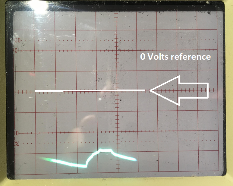

It seems the favorite DAC chip around here is the TDA1543 and everybody who has heard it raves about it, especially when multiple chips are stacked or paralleled. You know what they say: "If it sounds to good to be true, it probably is."
I recently purchased a Lite DAC-AH (eight parallel TDA1543) and gave it a listen. In a word: it’s BAD, e.g., not good. OK, it’s only $175, but it is still doesn’t sound good. The sound is coarse, crude, and congested. No detail, air, or finesse. Compared to an Audio Note DAC 1.2, it just doesn’t measure up. Of course, the AN costs hundreds more. Even compared to a stock ART DI/O, which costs less than the DAC-AH, the DAC-AH falls flat. Ordinarily I don’t care for the sound of digital filters but in this match-up I prefer the DI/O. An additional annoyance is the DAC-AH emits a constant squeal all by itself without being plugged into an amplifier.
The DAC-AH measures poorly, too. Here is the DAC-AH (upper trace) side by side with the DI/O (lower trace).
689.0625 Hz sine wave @ 0 dB
The problem is not in the output stage because I see the same thing looking at the top of the I/V resistor.
689.0625 Hz triangle wave @ 0 dB
With the TDA1543, a triangle wave looks more like a sine.
689.0625 Hz sine wave @ -7 dB
At -7dB the distortion is diminished.
689.0625 Hz triangle wave @ -7 dB
It appears the TDA1543's linearity falls off rapidly beyond 15 bits.

awpagan said:
is this a dac-ah bad design or implementation?
Hi.
Looking at the sine output, I would say that it could be either of awpagan's suggestions.
The waveform is asymmetrical and something appears to be limiting rather than clipping, given the shape. Power supply problem?
Andy

zanash said:I'm just saying its an unfair comparison.....of course the AH will sound bad......90% of all dacs will be put to shame by the audio note.
You clearly got that wrong; more than 90% of all DAC's I have heard, including a 1543, sounds better than the 4 models I have heard from AN
About the china-dac versus DDDac...: someone have mentioned it before; the devil is in the details...

It is about the raw ingredients. The TDA1543 is limited.

It is the fact, the 1543 is :bs:
The low cost version of the 1541.
Possible that some lucky people get a good one.
I recently tested old PCM53 and got huge variations.
The span was -35 dB harmonics from the worst chip to -60 dB from the best chip tested with -60 dB signal...
That means if one just plugs a chip into a board without knowing how good it is, the result is absolutely random.
8 in parallel does mean from statistics that there will be good ones and bad ones, and the bad ones will spoil the sound.
And 1543 is a stereo DAC which makes it even more difficult.
