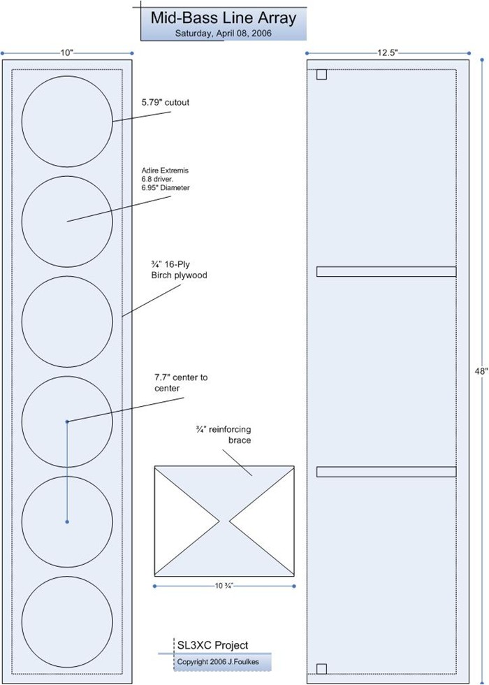

Enclosure design
One more thing: Enclosure design
Adire’s guidelines are for roughly 9.5L per driver in a sealed alignment, therefore the line array box is a simple tower that measures 48”x10”x12.5” to yield an internal volume of roughly 60 Liters in a sealed alignment.
Using six internal braces for reinforcement, the box is pretty simple to construct. All sides are 1” MDF. As the speaker is never really visible, the finish will be flat black paint.
Any opinions on the use of sealed vs vented for this application?

Drawings for Array
Here is the rendering for this project.
Again, a sealed box with six series/ parallel connected Extremis:
Opinions or constructive criticism are all welcome.

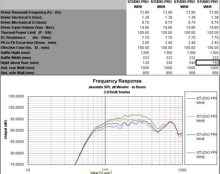

Hi Jon
I would strongly suggest that you build two woofer line-arrays, one for each side, especially at the frequencies that you will be driving then at.
Also, as much as I like the Extremis, I second the idea of maybe using pro mid-bass drivers, as I think that they will better match the electrostats ITO speed and dynamics.
Next, looking at the drawing of the proposed line-array it looks like you will be using open-baffle, but if the side-walls stretch so far back, you will be creating a short TL, not an open baffle, so be careful.

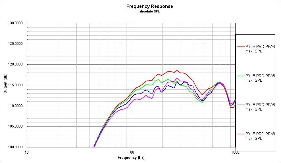

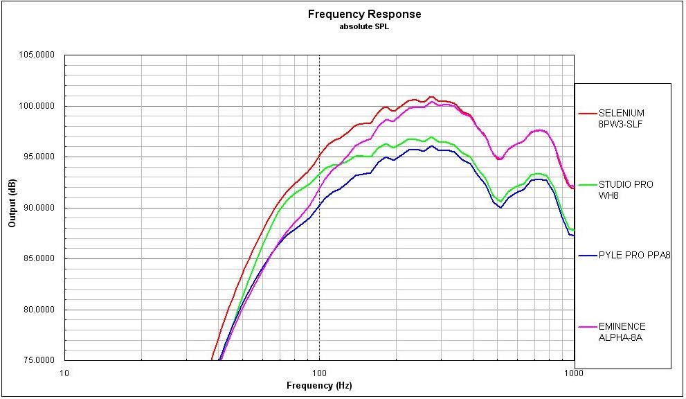

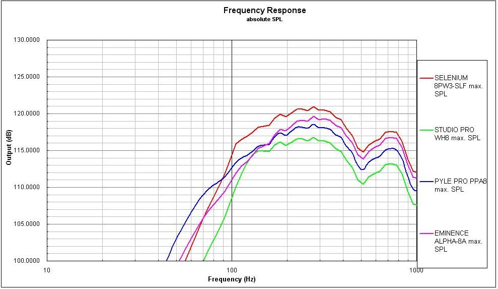

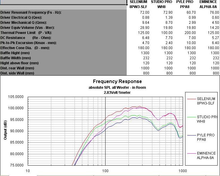

Consider this- if you make the baffle 9.12" wide, then the baffle-step point will be at 500Hz, your upper XO point. Considering this, I did a search on the Parts Express website for possible candidates. I settled on the following drivers:
SELENIUM 8PW3-SLF 8" DRIVER
STUDIO PRO WH8 8" WOOFER ACCORDIAN SURROUND 8 OHM
PYLE PRO PPA8 8" P.A. SPEAKER
EMINENCE ALPHA-8A 8" P.A. DRIVER
This is the results I got:

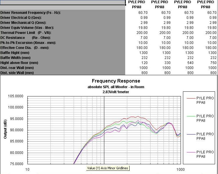

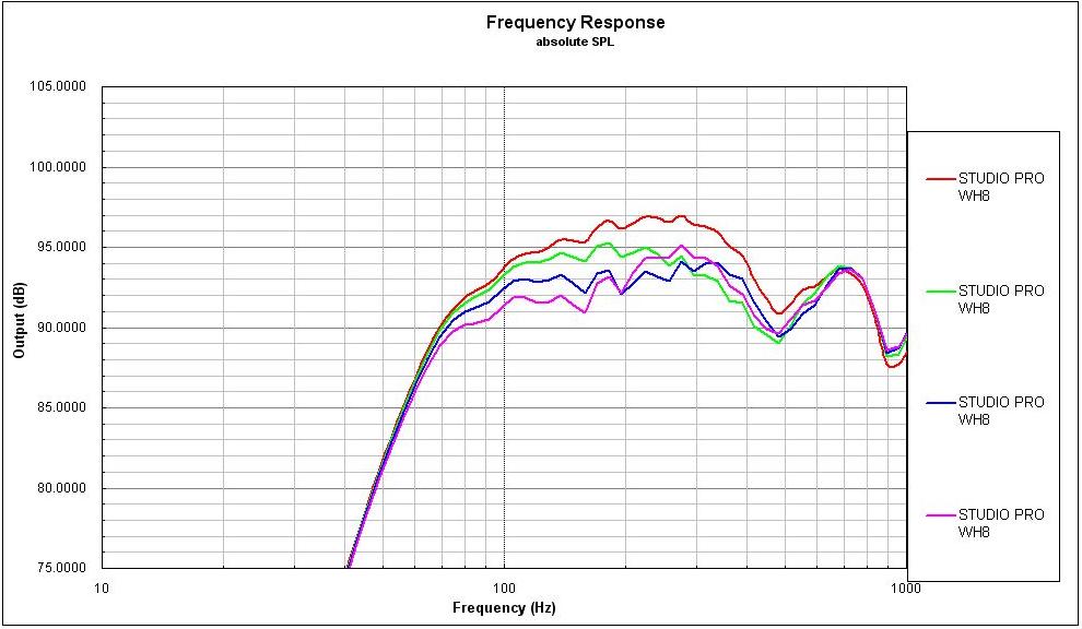

Of these, the Pyle Pro PPA8 or the Studio Pro WH8 seem the be the best candidates, so I modelled them on their own, just differing the height that they are mounted on the baffle. Let's start with the Pyle Pro PPA8. I could only model up to a four-driver array, but the baffle height is speced for a six-driver array.
Part 1:
