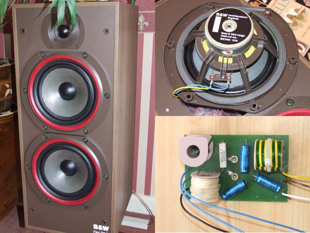

I did email B&W and the XO layout was the only info they had.
I have since taken it apart. Not so impressed: Chipboard (a lower desity than mdf) particle board, no bracing and a rather feeble looking XO board and connectors.
You can see from the photo that the chassis cut-outs on the drivers is going to make finding a replacement rather difficult
Realising that these speakers have had only a few hours use in the last 3 years (it is on my second system: Yamaha receiver and TV) I have taken the "rasping" driver out and put it on the bench.
Maybe the driver has stiffened up from lack of use? Anyway, I am feeding it with 15volts of 20Hz - 1Khz swept tone and we will see if it has losened up tomorrow!
Both 8" drivers are the same, ome covering "low bass" the other "middle bass".

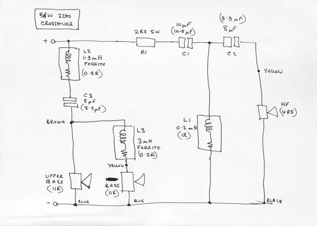

I have drawn out the XO in case anyone is interested. (How can I get more than one picture in a post ??:
This is the Crossover.
I have been out of electronics for 10 years (I have been doing IT networks, to put bread on the table) and do not have any current versions of schematic layout or simulator, hence the scruffy drawing.
Does anyone have the time and inclination to do a plot on this schematic? I hope this is not bad forum etiquette, but I am new around here.

Are you sure that circuit diagram is right?
There is a capacitor in series with the bass/mid drivers !!
David Gatti said:Are you sure that circuit diagram is right?
It doesn't look right, I agree. I'll check again tonight. I told you I was very rusty!

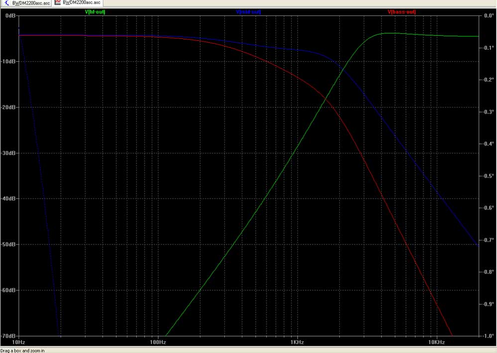

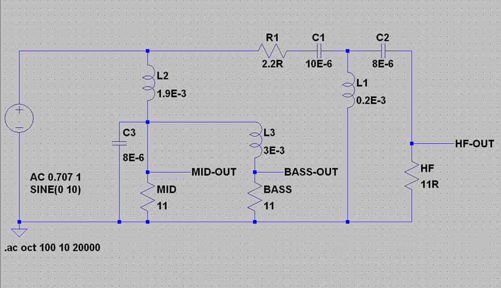

I couldn't sleep last night, so I DLd a copy of LT spice and started to put together a model. It is slowly coming back to me but the UI is a bit wierd.
How does one model a Speaker? Or do I just use is R value? I don't have any parameters for these drivers, nor an easy way of measuring inductance.
And the plot
Both 8" drivers share up to 2Khz, with the mid driver rolling off earlier.
No suprises, but an interesting design.
The bass is (was
) very punchy.
The faulty driver has been cycling on a sweep with about 2cm extension for 24 hours.
Now to see if it has helped at all.

Good work Cliff.
So it's a standard 2.5 way design. Maybe you should try to find a couple of cheap drivers at Parts Express.

2.5 way means you have both bass/mids covering the the lower frequency range to compensate for "baffle-step" (i.e falling bass response as longer wavelengths wrap around the enclosure).
One of the drivers is then rolled off at about 300Hz while the other continues up to the tweeter crossover point.

I suspected there are something wrong about the position of C1, C2 and C3. Otherwise in this network, the bass unit won't deliver bass and will reveal a deep hollow in midrange.
Re: Why do I keep losing attached files?
I suggest to exchange the position of C1 and C2.
