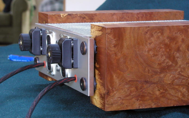

To keep up with the Joneses, I designed an integrated amp that pushes the envelope even further.
Starting with custom made toroids that have special windings and amorphous cores and dual mono design to the bridged amps output and TVC integrated volume control.
From the outside, the chassis is stylized by Levinson reference DAC and transport.

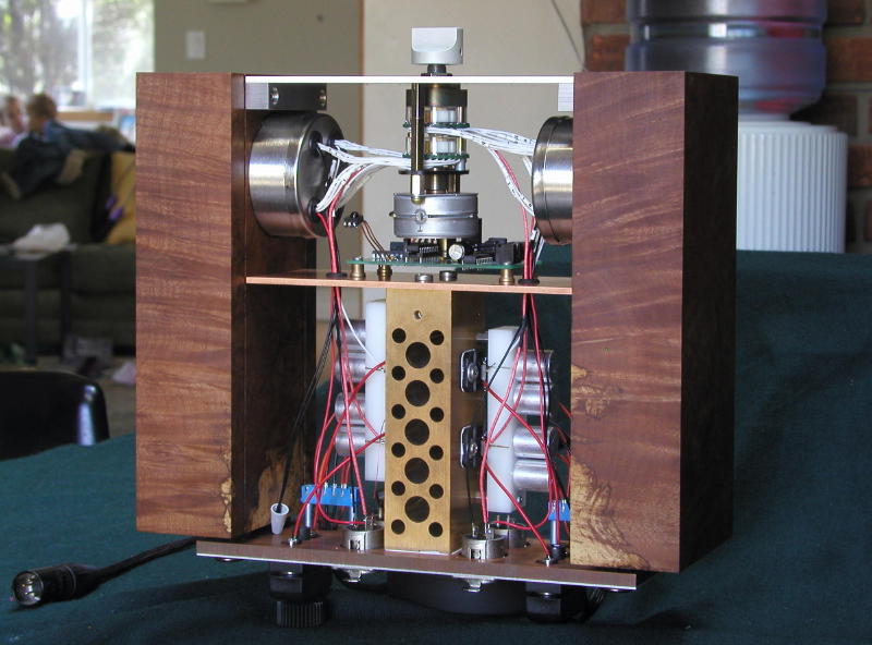

From the inside, I was really influenced by Connoisseur preamps layout 😉

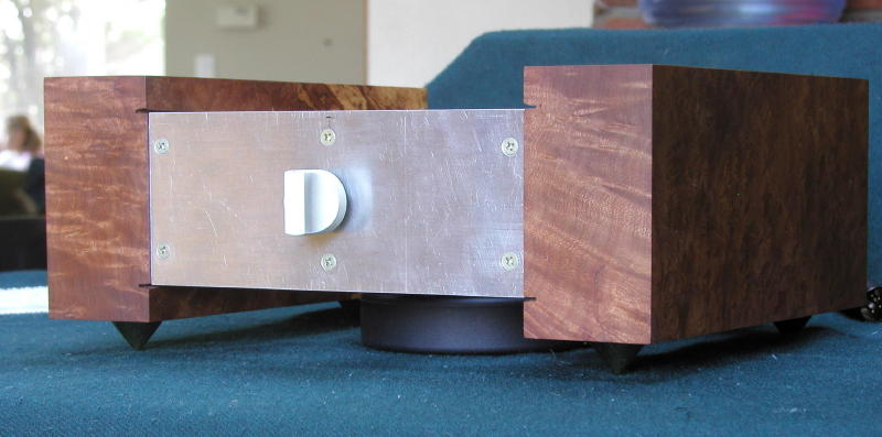

The front end consists of S&B102 TVC mounted on rubber dampers into Mardone Burl side panels. A stepping motor coupled to higher grade Elma switch allows remote volume control. The transformers act as phase splitters as well, allowing either balanced or single ended inuts and feeding the amps with balanced signal only.
The amps are basically Pateks in bridged configuration with a usual bypass scheme. The heatsink is made of bronze. Not a best material heatwise, but sonically better than other alloys.

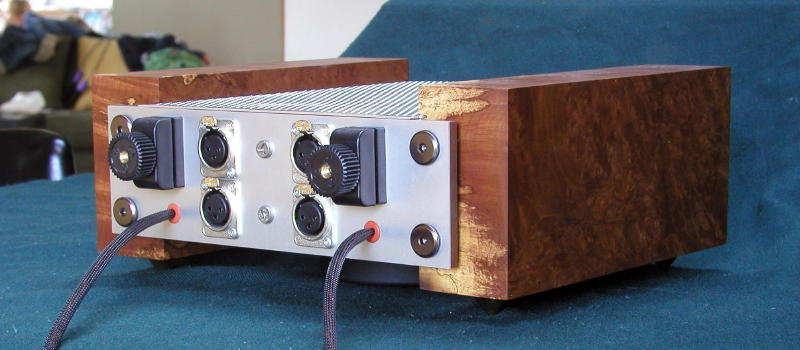

What is interesting though, the rear panel is decoupled from the rest of the chassis with special, aircraft rubber grommets. This allows for the main heatsink assembly to be rigidly supported in one point only, with a cone, reducing unwanted chassis infuences. The other two points of support are of a semi-flexible type.

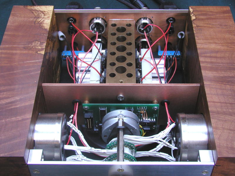

A close up of the inside with top cover removed (as usually made of perforated aluminum for low mass).
I'm running the amp presently with 4 ohm speakers. In bridged mode it gets pretty hot and clips at louder levels. Eventually it will be used with 8ohm rated Fertins, but also as a headphone amp with AKG1000.

1. What power and voltage have those toroids ?

Toroids are 300VA, 2 x 22V AC, single primary wounded over secondaries.
There are only 100uF caps beside the chips, the ones at the rectifiers are 1000uF.

Is there any problem with the switching motor interfering with the TVCs?
Best,
KT
I'm not getting any interferences from the motor, the control circuit is isolated by using separate PS. While turning, the mechanism make nice clicking and definitely isn't of a quiet type.
