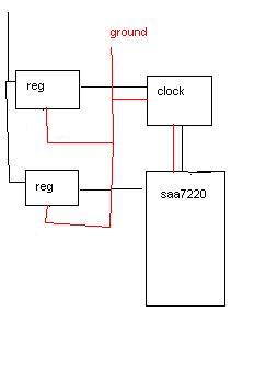

It was a 5V regulator with a 11.2896Mhz canned oscillator on a DIL socket. I was going to upgrade the oscillator to a low jitter type.
Yes, but this isn't enough information to help you.
I've asked some of these questions before... What type of 5V regulator and how was it connected ? What power supply went to the regulator input ? Did it come from inside the existing player circuitry or is it from an external transformer, rectifier and caps ? If a separate PSU, were the 0V lines connected together between this PSU and the player ? What evidence did you have that the oscillator was oscillating at all ?
You suggested before that you'd used a new regulator to supply the SAA7220. Is this the same regulator as provides power to the oscillator or a different one ?
Maybe it would help if you were to draw a diagram of exactly what you had connected to your player.
David.

L7805 regulator.
Power tapped from existing raw power supply both ground, and vdd.
I had two L7805 regulators connected to the same rail (separate reg for oscillator, and saa7220). Note the two regulators were mounted on the same board, and were quite close to each other.
The oscillator was working before I added the extra saa7220 regulator.
I've put the player back to it's orignial state (orignal quartz clock, and resistor supplying saa7220).
As suggested i've drawn what I did, and I can see the grounds I made were wrong (atleast at saa7220 end).
How did you connect up a supply for the saa7220 ?

This is a bit odd. 7805s should not have any effect on one another. Their proximity isn't important. Even if the heatsinks are connected together, both are at 0V. Are you absolutely certain that you didn't mis-connect something when you wired up the second regulator ? If you put them back to back, is it possible that you connected the input and output the wrong way around on one of them ?
I assume you had some capacitance on the inputs and outputs of the 7805s.
From what I can see in your diagram they are only "wrong" in the sense that the ground to the 7220 ends up meandering through the clock first. It may be better to have a star earth. However, this is a second order effect. I'd have expected everything to still work, but that you might not have had, say, the positive effect on jitter that you'd hoped for.
If the clock is currently in a working state on the separate board with the single 7805, then you ought to be able to wire that to the player without any other changes at the same time.
