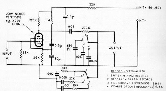

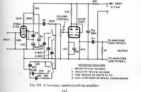

I tried building this preamp, but only put in the MAGN and TAPE equilization networks. I used it with a record player for years, but never tried it with a tape recorder. I like it better than the Heathkit preamps I have and the built-in preamps in typical integrated stereo tube amps.

That is quite a sure sign that the heater circuit wiring is layed out suboptimal. EF86 has bifilar wound heaters, helping to cancel heater-induced (mind: not heater feed wire induced) hum out in the tube (heater construction) itself.
EF86 itself is easily capable of delivering hum-free amplification with AC-powered heaters in the lowish two digit to single digit Milli-Volt input sensitivity range when sticking to recommendations and good engineering practice.
Instead of using the DC-axe I would try rewiring the the heater feed wires following the usual and well know recommendations to prevent heater-feed induced hum.

Yup, review your lead dress and routing. You can also bias the heaters positive from ground by 20~30 VDC. Lose the hum balance to ground first. Tap from the end of the B+ and stick a 10uF cap to ground from that point.

Yipes, this is where the difficulties come in. I suppose each of us has our own preference for a pre-amp circuit, even if not too different from the other fellow's.
First my contribution on the easy part: Welcome 7N7is. About d.c. on filaments, one must beware that it is smooth dc. Often not much more than raw rectified ac with a filter capacitor looks quite pious, but has such spikes that the noise is no better than with the "smooth" ac itself. I agree with Anatech here - BUT: with an input of 2 mV from a record pick-up, RIAA equalised, with the best of wiring it can be rather difficult to eliminate the effect of 18 000 mVp of 50 Hz in the vicinity to negligible proportions. I have managed this, but did find an audible (if not dramatic) advantage from using dc - but then, as said, smooth - in my case through an LM... regulator or such. The choice is yours.
To put it cautiously, my choice for a 2-stage pre-amp would have been for a pentode-triode or double triode equaliser (feedback to cathode) followed by a Baxandall + cathode follower (double triode). ..... but not to fault this circuit, if that is the choice. My greatest amazement is the second pentode stage tapped down to only 18% of the output in order to get a low enough driving impedance for the tone control - why not feedback?

The old page is gone so I put one schematic here and uploaded the other two to the forum.
