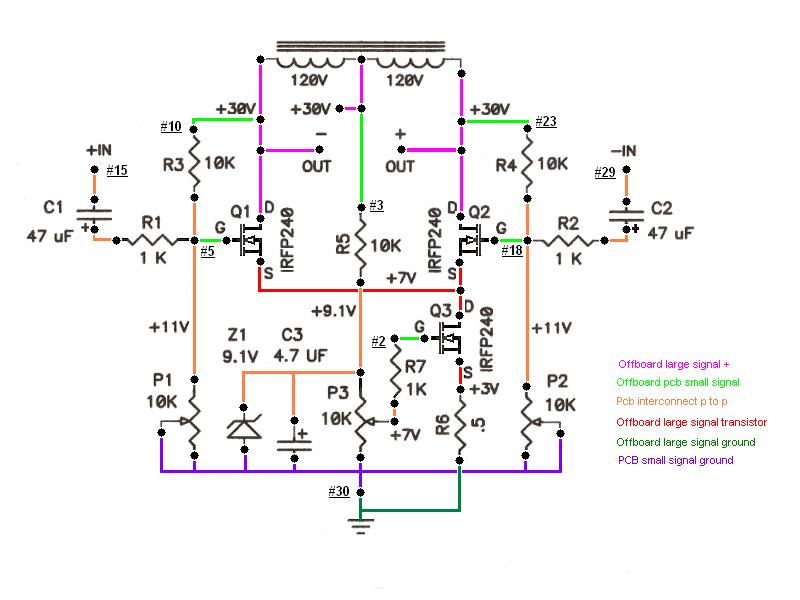

I'm fabricating the ZV7-T.
I'm in the process of submitting my pics and ideas for discussion.
Here's a drawing of Nelson's original artwork, but with colored lines to show where the onboard and offboard circuits belong. If I've made a gross error, please inform me. I'm especially curious to know how close the 1K resistors need to be in relationship to their perspective FETs.

Nice to see you have ignited the beast :cool: : You are definitely a bold guy :bigeyes:
I’m not qualified to go over the topology but could suggest some tweaking to see if it makes some improvement soudwise. Of course I’m not Nelson to come and suggest changes on the values but never the less I would try it.
You could replace P3 with a voltage divider now that you know you need 7V to the gate of the CCS if you are not planning to change the bias of the circuit. On the long run is better.
C3 is a bypass for Z1, as I understand it, it looks small in value and to work the best it should have a series resistor to load it. All of this with an eye to see if it does not produce thumps at turn on or off.
As Nelson says, the amp has very low input impedance (3K balanced), I remember you mentioned using a balanced line but can’t recall which one. The reason to ask is that you need a very low source impedance to drive this beast with authority. If it sounds bland you may need a lower impedance pre or add, as suggested by NP, an input buffer a la Z4.

I've reconfigured the PS to an LCLC format that gives me exactly 30 volts out. The amp reads as follows:
transformer center tap 30 volts
R-6 2.48 volts
Q1 gate 9.61 volts
Q1 drain 28.7 volts
Q1 source 5.25 volts
dc offset 1.5 millivolts (pretty cool huh?)
I'm reluctant to push the little fellow harder:hot: Another volt makes the difference between warm and supernova...
