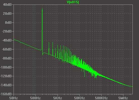

I use SwitcherCAD 3 which is a freeware implementation of
Spice. I don't think any other SPice implementations can read
these files, but I could extract an ordinary Spice netlist for
you. Or you could download SwCAD3. It is true freeware with
no limitations. You can find it at http://www.linear.com/software/
Although it is intended primarily for design of switching PSUs it
is a real Spice implementation so it can be used for any type of
circuit.
I tried with +-63.1V and max peak input voltage without clipping
is about 1.45V which gives just under 190W in 8 Ohms. Bear in
mind that there are a number of uncertainties in a simulation,
especially regarding transistor models which are not very
accurate. The simulation also assumes that the rails are at
+-63.1V at this output power.
I haven't run any distorsion analyses on the OptiMOS yet, but
I could do that. It is rather time-consuming however, so don't
expect any immediate results. Running distorsion analyses
in Spice is of questionable value, as was discussed in another
thread, and I use it mainly for comparisons between different
designs, to get some idea of their relative behaviour.

By request, some distorsion results from Spice. I've used
Rarkovs raíl voltagees of +-63.1V, input 1.45V peak, which is
about max before clipping with this rail voltage. Output is
c:a 190W into 8 Ohms.
Minor notes: I use 2N5401/2N5551 also for the diff pairs. Perfect
current and voltage sources are used for biasing the diff pairs
and the cascodes.
Major note: This is just a Spice simulation, so don't trust the
results to have much to do with reality.
Figure 1:
Output spectrum for 1kHz sine wave. Both 2nd and 3rd
overtones are down between -75 and -80dB.
and the cascodes.
Figure 1:
