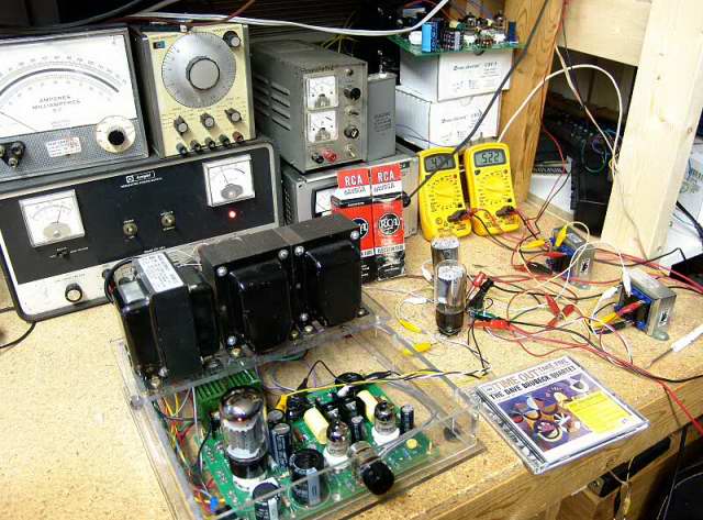

I wired a pair of 6AV5's and a regulated power supply into the same TubelabSE that I had been using for these tests before. The first test was ran at the rated 11 watts dissipation, 300 volts and 35 mA. The amp sounded OK but kind of subdued. In my usual style I turned up the power. Much to my surprise they starded to exhibit the death glow at about 15 watts. This is not what I saw before. These were NOS tubes, not dirty old ones. So I found the old tubes that I had used before. OK now I can crank up the power. I was running 350 volts at 60 mA with no glow. They sounded nice, good bass, clear sparkling mids and crystal clear highs. I listened for two hours with a wide variety of music. It sounded good, but not as good as the Edcor with the 300B.

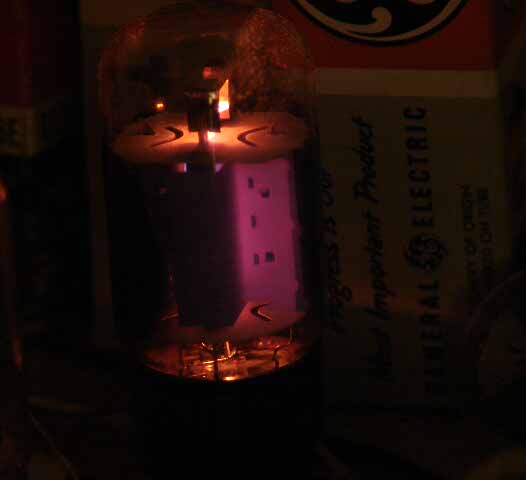

In one of the previous threads someone suggested the 6FW5. I put a pair of these into the amp, and cranked it up to 350 volts 65 mA. No deasth glow, and It rocked. This was the best sounding combo yet. Tried triode, UL, and pentode connections. The results were as expected. My next experiment will be to try cathode feedback.

I was surprised to see the red glow of death appear in the NOS pair of RCA's at 15 watts. I dug up the pair of tubes that I used for the original test, and re - tried them. They both were able to take about 30 watts with NO glow visible even with the room lights off. One of these was a GE and the other was a Dumont. They were of obviously different internal construction. Upon further investigation I found at least 5 different internal constructions for the 6AV5GA. The NOS RCA's that I tested had large slots in the radiating fins at the point where the fins attach to the plate. This would limit the thermal conductivity. What were they thinking? I also found RCA's without these slots. I have some Sylvanias, and several other flavors, I will stress test them as soon as I get time. I will be out of town for most of this weekend again.

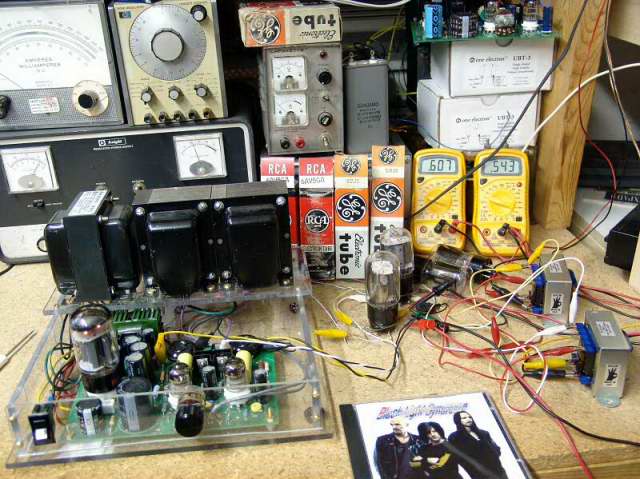

Well, I thought about this for about 10 seconds, and then I opened up some 6AV5 boxes. One of the tubes in the original test is a Dumont brand. Upon further inspection these are made by Sylvania. I have 6 distinct types of 6AV5 tubes. Two types of RCA's (with and without the slots in the radiating fins), two GE's, a Raytheon, and the Sylvania. I have just finished torturing (I mean testing) each type. The dissipation figures that I use are total (plate and screen) tube current times actual plate to cathode voltage. All tubes were tested at 300 volts triode strapped unless otherwise noted. All of this testing was done at very low volume (milliwats), this is worst case for dissipation. Sherri has freinds over, so I can't crank it up loud anyway.
The slotted RCA's start glowing at about 15 watts, this is only slightly above the 13.5 watt rating. These all have the newer style lettering on the boxes and two letter date codes.
The non slotted RCA exhibited no visible redness at 30 watts. At this plate dissipation, I could see the screen wires begin to glow if operated at 325 volts. No glow was seen at 275 volts and 30 watts. These tubes all have taller glass and 1963 date codes. 4 tubes tested.
The Raytheon (I only have one here) started to glow at 23 watts.
There are two types of GE's. The newer ones have plates with rounded corners that look identical to those in the 6FW5 which carries a 21.6 watt (total) rating. I tested 2 of these. One showed a slight redness, only visible with the room lights off at 27 watts. The other showed no color at 30 watts.
The older GE's have the smallest plates and smallest envelope of any of the tubes tested, but they seem happy at 27 watts, and just show slight redness at 30 watts. 4 tubes tested, all the same.
The Sylvanias are clearly the best of the bunch in the overload department. When you push them hard enough to get them glowing the entire radiating fin glows evenly, no hot spots. I got a few minutes to listen to the Dumonts at 315 volts, 80mA, which is the sweet spot for the Edcor transformers. They do sound nice, but I am not quite raedy to trade in my (Chinese) 300B's. There is no visible at this level, and it takes 30 watts to see any. 2 Sylvanias, and 2 Dumonts tested. Both Dumonts have the Sylvania EIA code 312 on them. The included photo was taken at 315 volts and 130mA, this is 41 watts.
Considering that a 6B4 is only good for 15 watts, I would use any of these tubes except the slotted RCA. Guess which one I have the most of?
