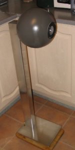

W3-871s over bright.
I have recently finished my W3-871s pictured below. As yet they have no filtering at all. I am very impressed with the imaging but they are too bright. I would like some advice on how to tame the highs preferably without ruining the imaging.
As you can see they are in a closed spherical enclosure which is about 3 litres.
Regards BT

Zaph audio has a notch filter designed for that driver. It really needs one, its got some awful peaks in the high range.
Don't fear the filter, and check out: http://www.zaphaudio.com/archives.html
The W3-871 design is the third one down, I think, download it and take a look at the filter, it might be the ticket.
I don't think you'll need a baffle step compensation, because of the spherical enclosure.
peace,
sam

Probably the baffle width can be the diameter of the driver initially. In reality it also depends on the driver FR, so you might end up with an optimum baffle somewhere smaller than the diameter of the sphere.
The inductor and the resistor is mostly what takes care of the baffle step.
How did you make the sphere? It looks nice.

Mind you that 871s in a closed 3 litre enclosure does not go even to 100Hz (I have built such) and this thing adds to the feeling of brightness too. Best thing is to cross @ 150Hz with a sub and avoid a circa .7mh coil that will make it travel hard.
Zaph mentions that the W3-871S doesn't need that much compensation due to its natural frequency response. I assume the notch values chosen account for this.
You can't guestimate your notch values based on Zaph's design since yours is quite different. You will probably need to measure the FR to design an accurate notch.

Hi, I basically suspect, as Vikash said, that 0.7mh maybe too much. There is the danger of overexcursion or a thick sound, or both.
But basically we dont know what is at play in your system as a whole. Can you take measurements of both sat responses and impedance? I will be happy to simulate your needs in Leap or Soundeasy.
What more can I tell you. Basically I will have a very similar volume to Vikash, a sealed enclosures like Vikash and the same driver as Vikash. Only my enclosures are spheres of 22cm (8.66 inches) external diameter.

zaph's filters are designed to reduce a small hump is frequency
response and reduce the hump caused by diffraction/baffle step.
A sphere should not have the hump, just a smooth transition.
The low diffraction box has a 1.5dB hump, the 5.75" box is not shown.
The filters are low Q and implement baffle step for lower
frequencies and extend the treble for higher frequencies.
They only differ in the centre frequency, by my calculations,
2.3Khz and 3Khz, but this doesn't include the drivers inductance.
Because the sphere doesn't have a hump I'd reduce R to 5.6R.
Might sound like a cop-out but keep 0.7mH and use 4.7uF.
You should be very near what you need, and have a lot better sound.
As your using subs, a 100uF series capacitor is going to be better than nothing.
(Bypassed with a similar quality / value capacitor to the above)
edit: I don't suspect 0.7mH is too much, R controls the amount
of baffle step and consequent effective treble boost/extension.
:)/sreten.
