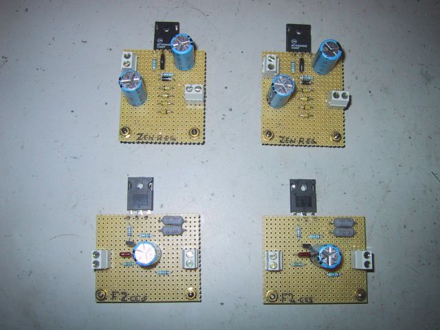

For this amp, I made some perf-board modules, for making it easy to test things:) Here is a pic of the CCS's and the reg's. The zeners in the reg's are not connected at this point:) Have a look at the CCS's and reg's:)
Steen:)
