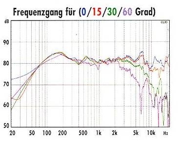

This plot was FR125S

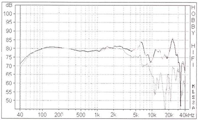

"Klang+Ton" tested WR125ST and FR125S, "HobbyHifi" magazine tested all three and will develop a kit with WR125S in a TML plus Dayton PT2 ribbon. Haven't scanned all reviews yet.
Below is FR125S 0 / 30 degrees of HobbyHifi (look at the top end - up to 30000Hz!).
